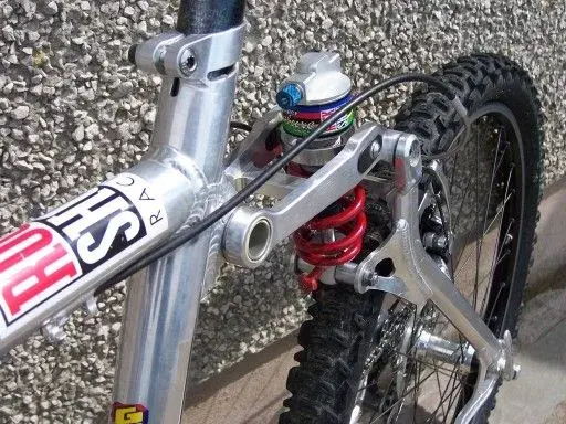

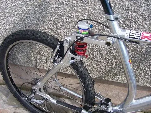

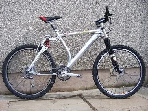

here was my old 1998 ds1000

very nice, do you remember how much travel you had?
figured out there is basically a reversaible delrin bearing that can be swtiched between two positions, for the sts 1, sts 2 and lts 1 this gave between 3.75" and 4.75"s of travel, im not sure what is was for the DH models.
have also confirmed that the 97 lts/sts had ride height adjust via its trunnion mount
"the trunnion moint is a threaded coller in which the shock is threaded into, this allows the rider to slect his or her ride height and, in addition, can affect the total geometric attitude of the bicycle in terms of head tube angles, seat tueb angles and bb height, simply grasp the top cylinder of the shock and turn it. as ou turn the shock it will thread itself up or down the collar, as more of the brown upper cylinder of the shock becomes exposed, the bike lowers itself which reduced the head and seat tube angles'

in my opinion no, things were moving so fast back then that one years full on dh bike was next years all rounder, i think in basic performance they are very similar. the rear of the bike is near identical.
as we have found out they both have similar (adjustable) travel, both are (supposed to be) ride height adjustable, although the DH frame is beefed up around the seatube area, more of a sloping top tube, and with the top link further up the seat tube, has slightly slacker angles on standard settings.

BTW about the adjustable travel, the two bushes at the top of the shock on the trunion mount are refered to as travel chips, the hole is offset, travel is determined by which way the hole is (to the front or the rear), the height of the bike is adjusted by turning the whole body of the shock through the trunion, spring preload is set by the seperate collar under the trunion mount, this is how i've set mine up anyway.
