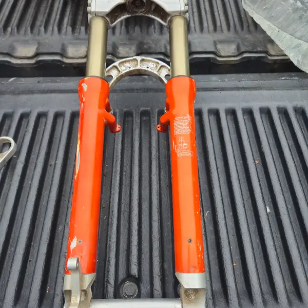

These are my original World Cup lowers but redone in Cherry red (the same colour I redid my original M1 before selling). Newer wheels and Intense Edge, Comp 24 rip-off, tyres.

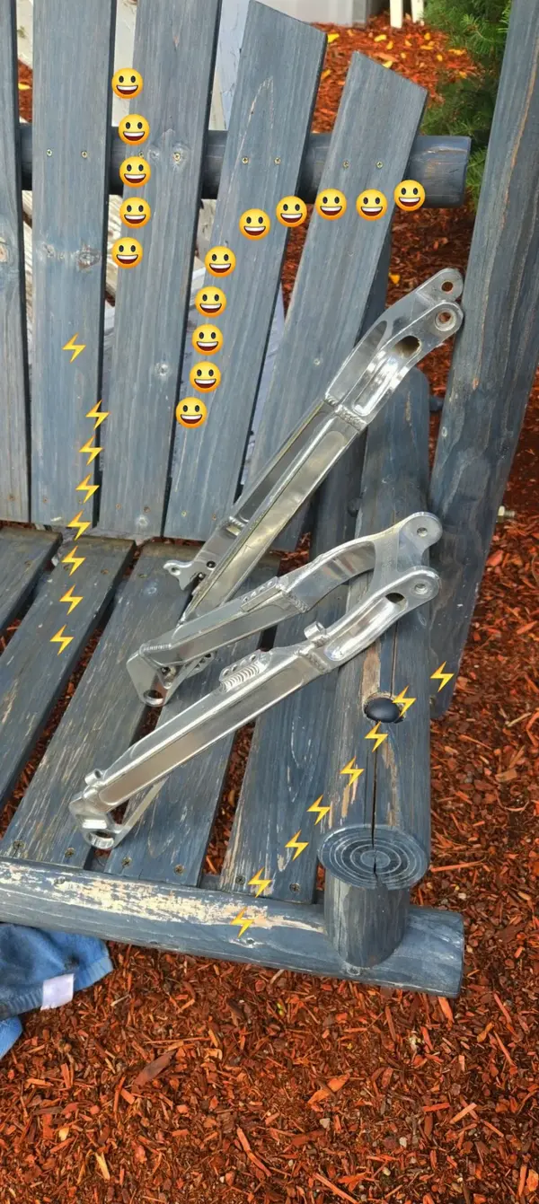

Something is definitely missing from the shock. This is an early Progressive/5th element frame, partly from the cable guides on the front end which were of the twist in variety rather than zip toe tabs, and because this link has been machined after anodising to fit the later 5th shocks. The original Fox Van RC in the previous generation frames was narrower diameter and didn't have the same clearance issues this did when installed in the middle BB height setting. The lowest setting also originally had threads which have been removed as if used with the 5th would lead to the shock piggyback hitting off the underside of the seat tower and bending. Later ones were machined pre-anodising and didn't have any threads in the lower hole.
I really need to track down a new end cap for the axle. Also in the picture is the 68mm front Hayes caliper which definitely doesn't work with the 74mm mount. I do have a pair of 68mm manitou lowers but they're more Tazer than M1, and I already have a Hope C2 caliper for them.

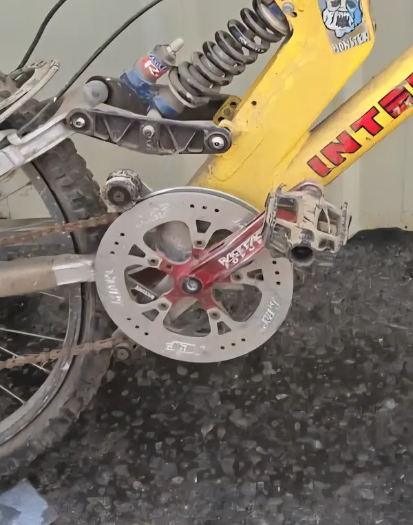

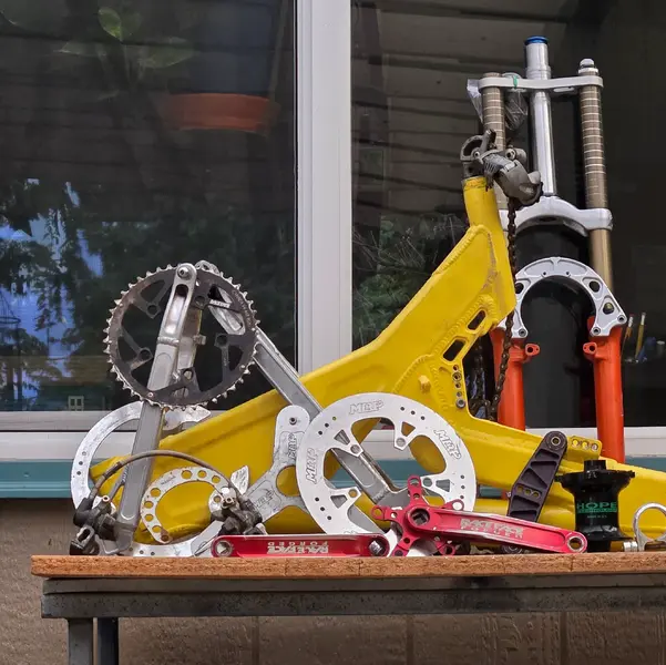

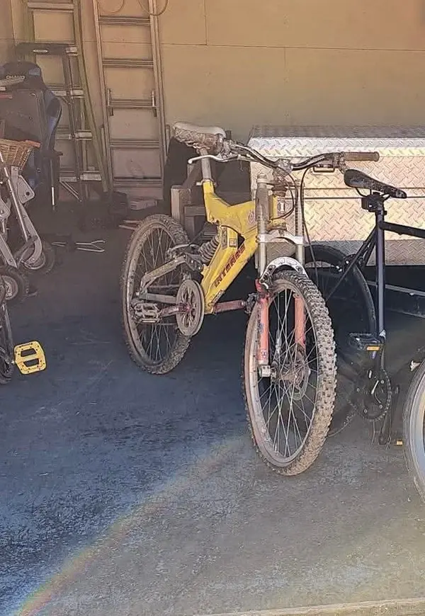

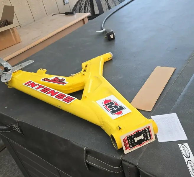

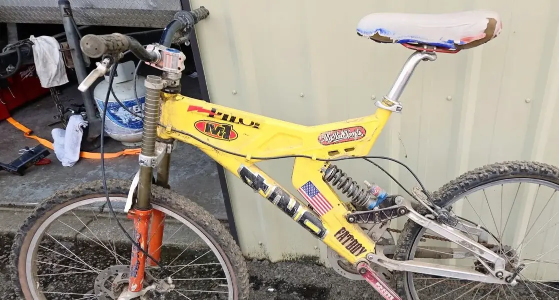

Mine is a 97 and had it since the day I bought it, raced local in the NW of USA for about 4 years. Then after I have just kept it stored away wherever, always dry tho. Then about 2 months ago I pulled it out and began pulling it apart. I had retrodecals make the new decals and I had to take the pictures abd measure because Gil was unable to locate my stickers by sight of the pictures I sent him. Don't remember what he found different now.

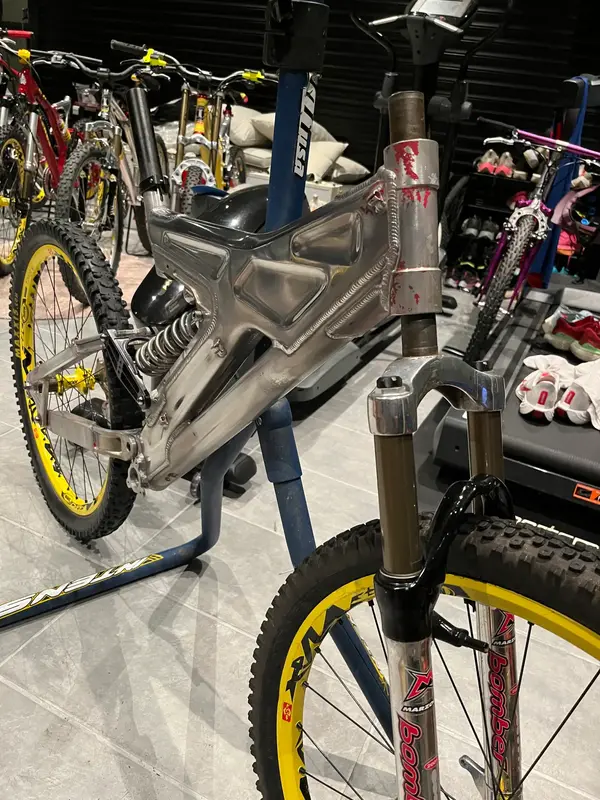

Got the old MR T just rebuilt and is currently in postage coming back home. The bearings are all still doing fine , very minor dent. Still have the azonic bars and honestly some generic stem that has never failed. The C2 Hope brake is still magnificent and its matching behemoth Hope hub up front. The rynolyte wheels have been smashed and plenty if dents etc so there out, I am replacing them with the newer ryno XL. The rotor screws were impossible to remove three of thembso I had to get creative.
Now that old magura classic rim break I used and it actually did pretty well considering. That poor thing pretty much rotted over the years, so I bought a HS33 and was not liking how that whole look was.

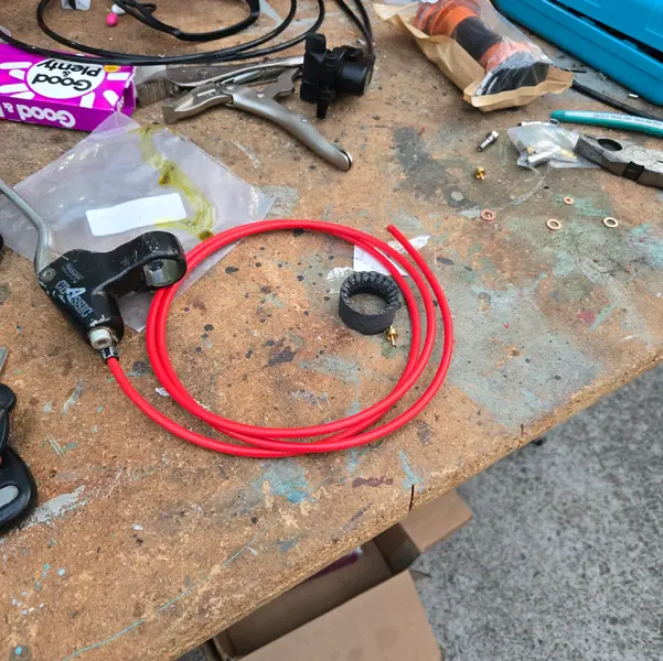

But thanks to this fine group of folks I learned about the hope adapter, and honestly don't know how i never heard of or was shared that information soul many years ago. Just finished emailing intense to verify which adapter is the correct one. I'm a carpenter not a machinist.
I'm not so worried about keeping it all old school, I bought the new hope tech 4 brakes. My derailleur was shot and I bought new but basically the same 8 speed sram, my race face cranks were fine but shotty looking so I got bothered basic sram gx eagle.

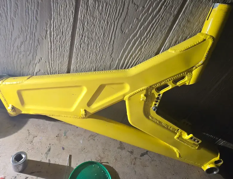

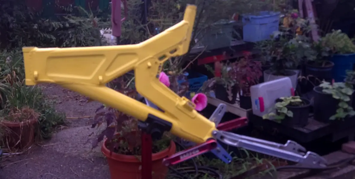

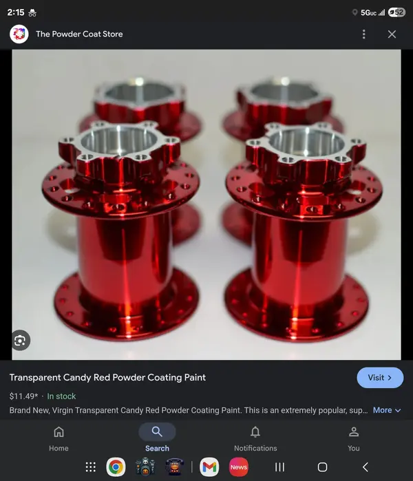

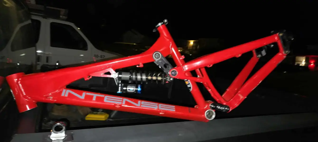

And I have a powdercoater ready to recoat the frame even tho the paint is pretty much fine.
I'm going chrome candy apple red and chrome black on the rear linkage.
Here's the red
