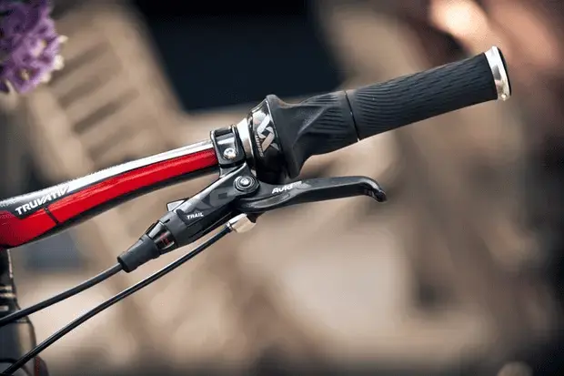

As a user of twistgrips or GripShift they are really nice especially if using it relaxed and commuting.
I prefer the half pipe versions for commuting as you sit on the shifter when riding and everything is easy and just works.
Which one depends on the number of rear gears, or if only for the front, then SRAM Attack halfpipe are nice or any of the newer ones should be good too.
some random plucked of a picture search examples
older
newer, not actually half pip but to give you an example.
some have bearings in them and stuff to help out.

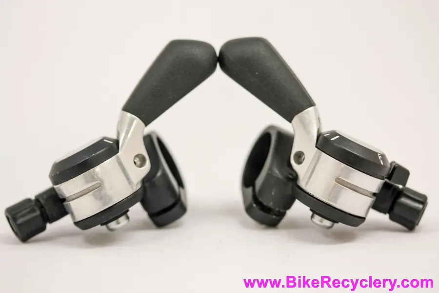

You could look at chucky thumbshifters, these can be shifted with the palm of the hand on the top.

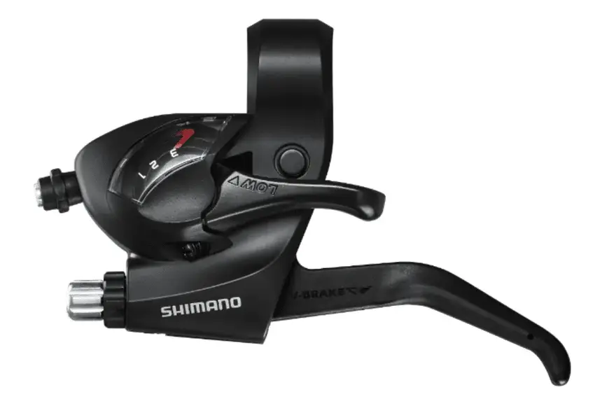

Do you have a picture of the current shifter?

Her current shifter is a Shimano EZ Fire Plus with a Tourney mech and she only needs the front triple. Very much low budget to test the water and see how she gets on with MTBing.

What are 'chucky thumbshifters'? Google throws up some interesting results!
