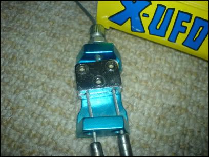

Could you use a better lever and one of those BMX thingy's that split the cable?
I found this pic with google:
