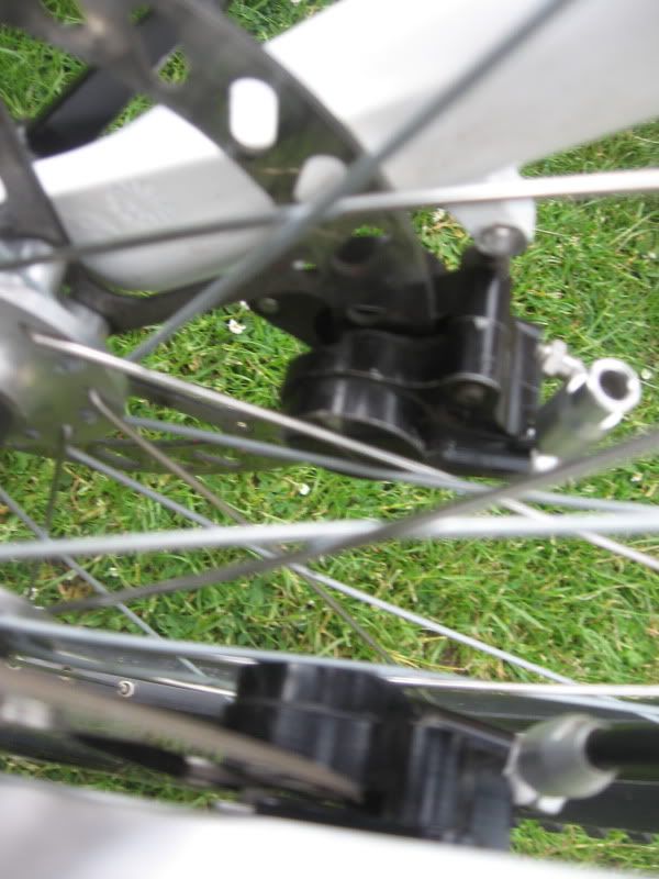

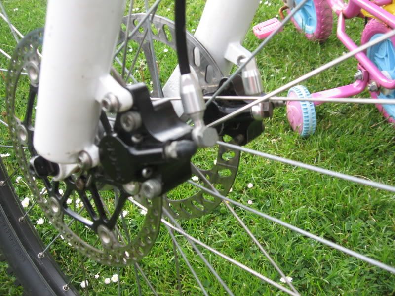

i got fed up waiting for the adaptors so i drilled the mounts out :oops: now fully working and running twin 165mm front discs :twisted:
the hydro set up just needs a little tab welded on then plumbed in :wink:
chuffed to bits with them :D :D :D
jimihendrix":3lpzggdt said:
Cool 8) , how are you plumbing the hoses into the lever though ?
either a double banjo bolt or a small alloy box to split the hoses , havent decided yet :lol: :lol: :lol:
i'll be using a sport lever at first (you know the one that can be flipped over and used for front or rear) if it's spongey i'll try something else :lol: :lol: :lol:
I don't think it's going to be a matter of if. The Gator kit uses a radial moto lever. Probably a 19 to push the dual 4s. I'd hazard a guess that a 13mm Brembo would be about right.
