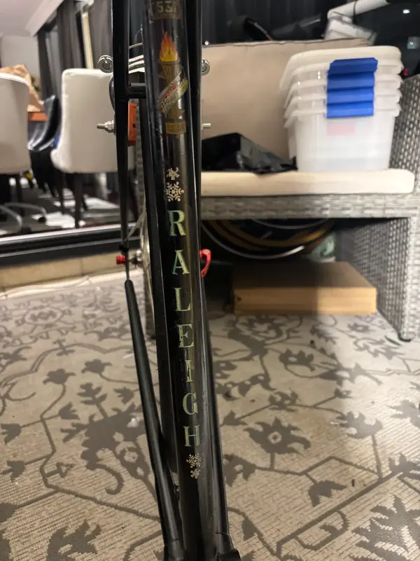

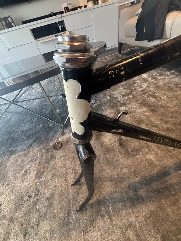

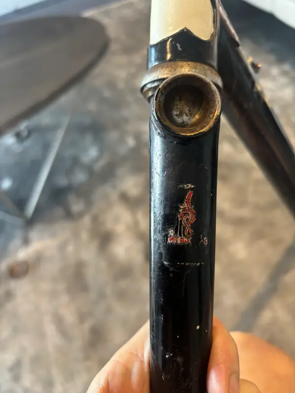

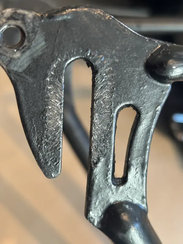

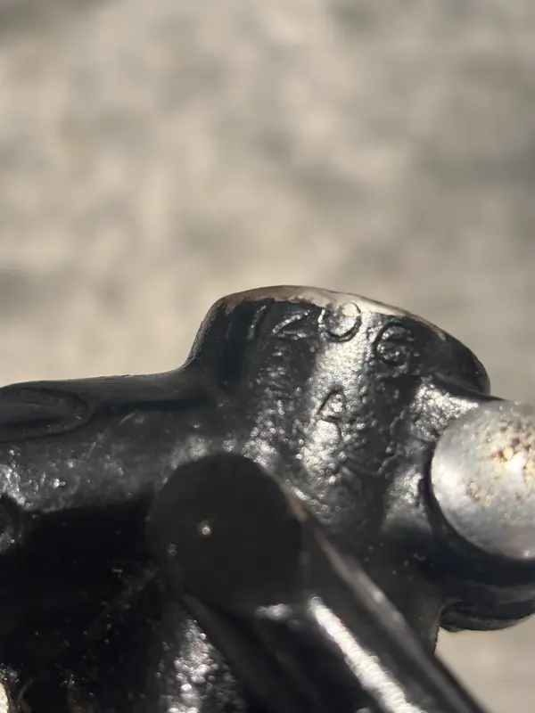

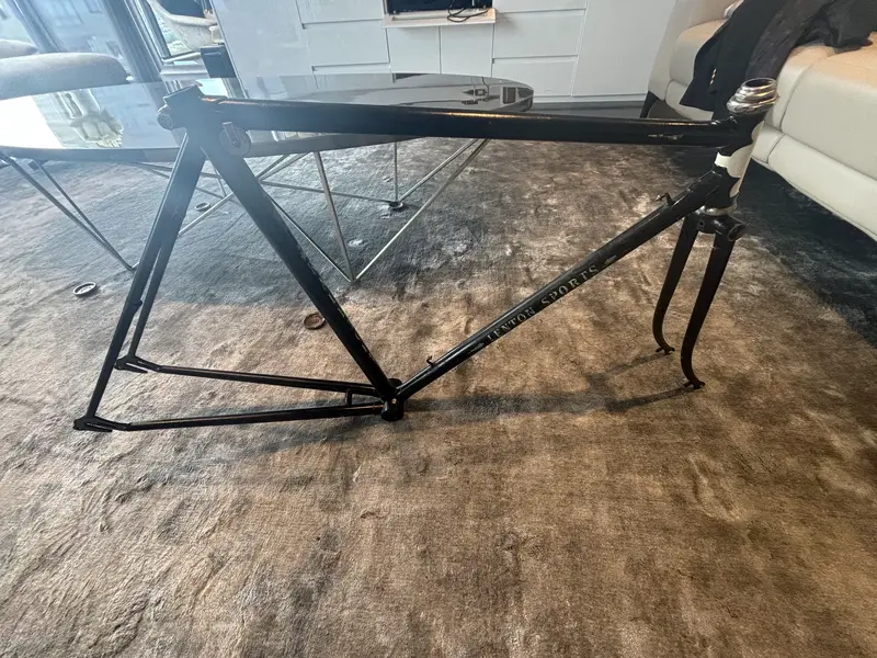

I have just acquired a Lenton Sports frame in quite decent condition. I am trying to identify the model specifics before embarking on restoration.
It has the Reg Harris Olympic torch logo and, unusually, the "Lenton Sports" decal is on the downtube and "Raleigh" runs vertically down the seat tube. The frame number (on the seat lug) is 77206RA.

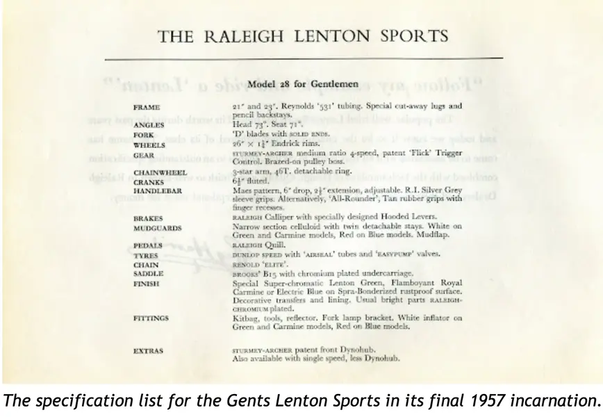

I am thinking that this is an early 1957 Lenton Sports because:
1. from https://on-the-drops.blogspot.com/2...0.html#:~:text=specification changes for 1957
"specification changes for 1957
downtube transfers for "Raleigh", "Rudge" or "Humber" now vertical on the seat tube
model name now more prominently displayed on the down tube
new 'flash' styled white peak head treatment"
2. later that year the Lenton Sports was replaced by the Lenton Grand Prix with 27 inch wheels and derailleur gearing
3. it is consistent with the frame numbering (late RA series)
However, what has me flummoxed is the colour - black with cream head tube. I am thinking it should be green, red or blue. I believe the Lenton Grand Prix released later that year had a black with cream head tube paint job but this is not one of those - no derailleur fittings. There is no evidence of repainting.
So what do I have here? All advice gratefully received!

More photos of the frame including serial number

I see that you've already found the most comprehensive website i.e. "On the Drops".
The Raleigh catalogues usually stated the posh "new" eye-catching colours for a particular year - but what they didn't always say is that most models were also available to order in the "standard" range of colours i.e non-metallics, green, black, red etc.
The transfer positioning appears to be correct for early 1957.
Great to know, thank you. So I have a 1957 Lenton Sports (which happens to be the year I was born). I'm going to enjoy restoring this one.
I already have a dilemma with wheels. Looks like the bike originally had 26x1-1/4 wheels (597) which are impossible to find. I'll need to go down to 26x1-3/8 (590) or up to 700C (622). Down feels better - at least that was a proper British size at the time. I have found a nice set of GB Coureur 66 brakes for it so I'll need to work out how far they will reach. 3.5mm shouldn't be too much to ask hopefully.
I have serial number 81304 RA (Lenton G.P.) and I am under the impression that it is a 1957 (the year I was born, too), so yours could be as, well. I know Raleigh numbers aren't necessarily sequential, but 4,000 frames away from eachother's gotta mean something. I think you could touch up your down-tube decals with masking tape guiding you.
That is interesting! Did yours have similar 1957 decal layout? (Raleigh vertically down the seat tube and "Lenton Sports" running along the downtube). I am getting some reproduction 1957 decals made and, given MOQs, would be glad to give you some.
