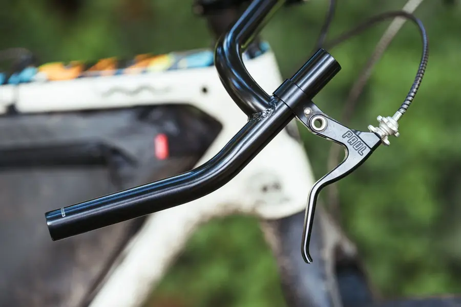

Coming at this drop bar lever feel problem from a different angle: have you guys seen the Surly Corner bar? It lets you use a flat bar lever and shifter before changing groupset if you're trying out drop bars, but also means you don't need drop bar levers with your mechanical disk brakes on road/gravel bikes.
