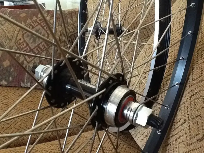

Wheel set has arrived. Very good quality. Smooth bearings and substantial spokes.
Black Ops hubs. Sun Ryno lite rims.

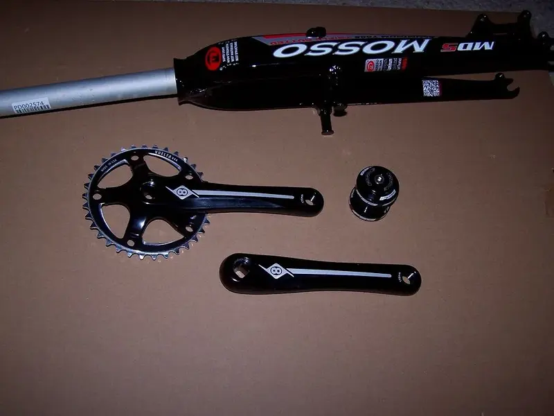

New cranks installed. They line up nicely with the rear.

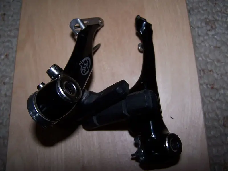

I am digging deep into spares and came up with some old Avid V's that will go on the front. Not sure what I'm doing on the back. I am thinking of a disc adapter that goes on the flop side of the hub and a creative bracket.

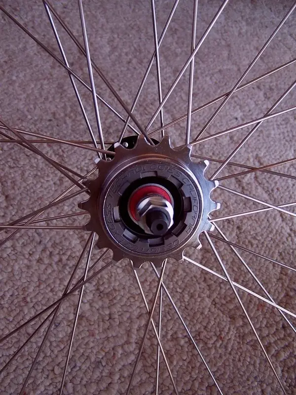

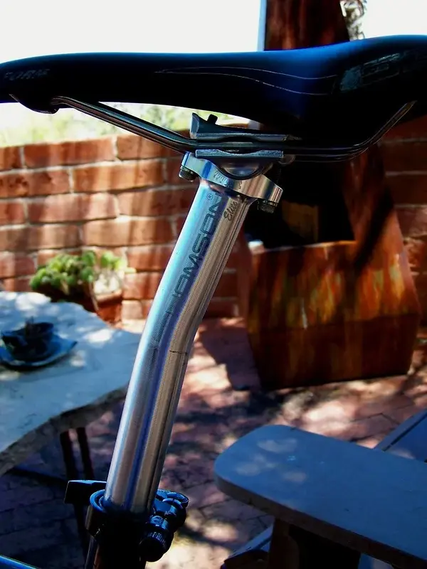

Freewheel and seat post installed.
