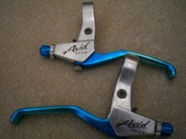

After years of having not so good brakes, i think the mrs levers are canti :oops:
Looking to trade for some sort of ano red v levers, could put in some cash for different ones.
Avid SD2.0 (L?)
Polished up the bodies as the decals were scuffed. In great condition otherwise.
Can do bigger pictures if needed.

It's the distance from the pivot to the cable anchor, so not really modifyable...
You can get in-line adapters but I doubt it's worth it. Howsabout some nice cantis...? :lol:
someone mentioned on the other post that you can just adjust the dial on the top of the blade and they'll work fine.

They may work a bit better but not as well as V levers.
cyfa2809":2lz5x7hb said:
What actually ascertains the pull ration on these brakes? Is it in the lever or the body. Im thinking maybe i could switch the levers onto 'v' bodies
I think you can swap the lever blades. The bodies are the same. I think.
So you think the levers are different?
Yeah they work ok, just very spongey with the dial as suggested.
