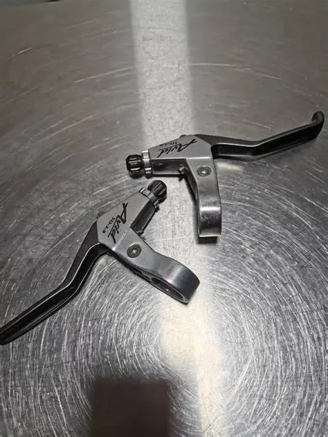

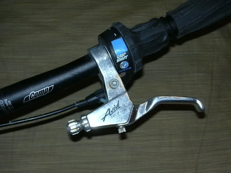

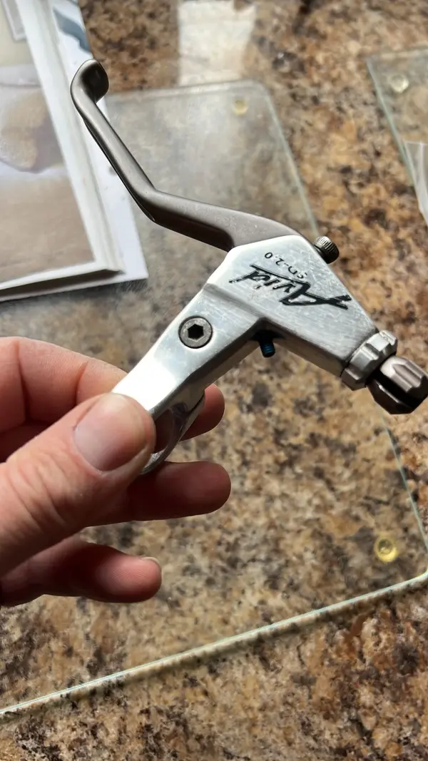

Generally the ones with the longer levers and no crumple zone are Canti compatible. Some say the speed dial can make them do both but I have never found this to be the case.
I personally find that the Speed Dial helps to adjust the levers to some extent do support both, cantilever and v-brakes. At least running "L" levers orginally for V-brakes with Canti does work for me OK.
But here is a bit of history and more information on the Avid levers
To my knowledge, the Ultimate had been originally designed for Cantilevers.
They got later a different internal chip to be able to support V-Brakes, a picture of this chips is at this post
The SD2.0 without "L" had been to my knowledge designed still for cantis.
We have recently discovered that also certain bikes like the 96 Barracuda AL750 had been officially equipped with those 2.0 levers in combination with Onza HO cantilevers.
The ones with "L" than for V-Brakes.
here is a bit of history on the Avid levers
