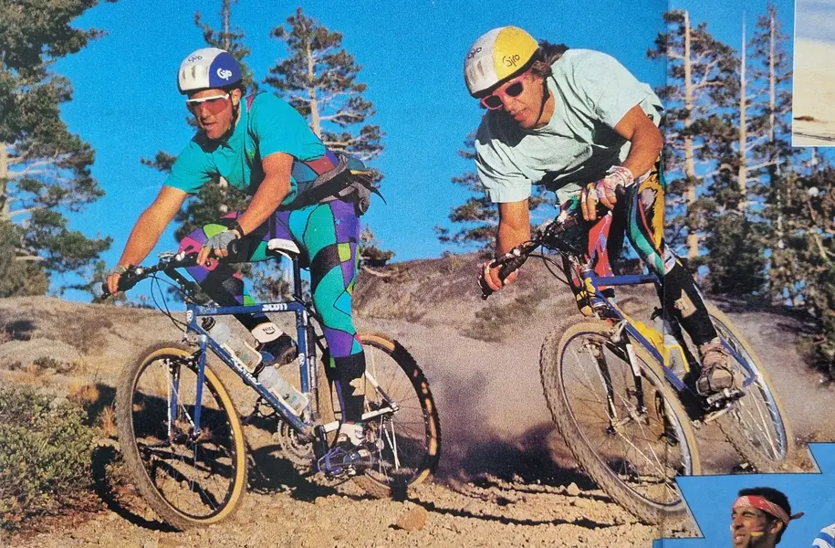

Does someone recognize the Scott bike below in the picture on the left side?
Scott "Ritchey" with Switchblade?
The pic was in an Bike mag from 1989.
double downtube bottle cage and tange prestige sticker would suggest it's a ritchey supercomp with a different fork
Thanks a lot. That does make sense.
I was wondering also if there was some kind of official cooperation between Ritchey and Scott? Maybe the Scott label is just a sticker and has nothing to do with the bike? I somehow thought I have seen a similar Scott somewhere else.
I was wondering also if there was some kind of official cooperation between Ritchey and Scott. Maybe the Scott label is just a sticker and has nothing to do with the bike, I somehow thought I have seen a similar Scott somewhere else.
ritchey back then provided scott frame tubes and other bits (drop outs, headsets, seatposts etc.); I wouldn't be surprised if they also provided complete frames in the very early days
