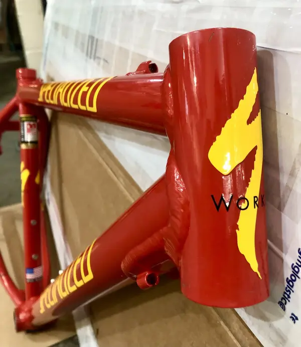

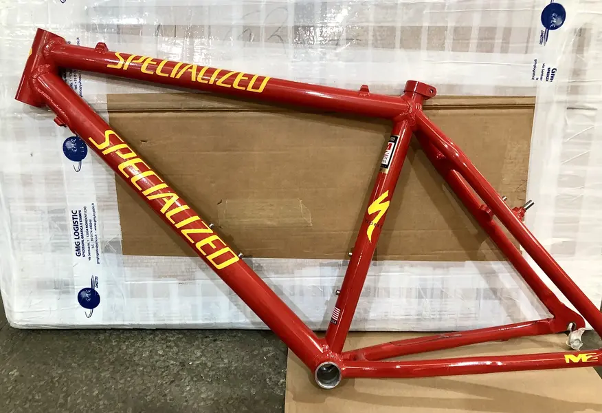

I’ve got this ‘92 frame that I’ve yet to build up ….
Not sure if this has been repainted but was purchased as a low mileage frame….

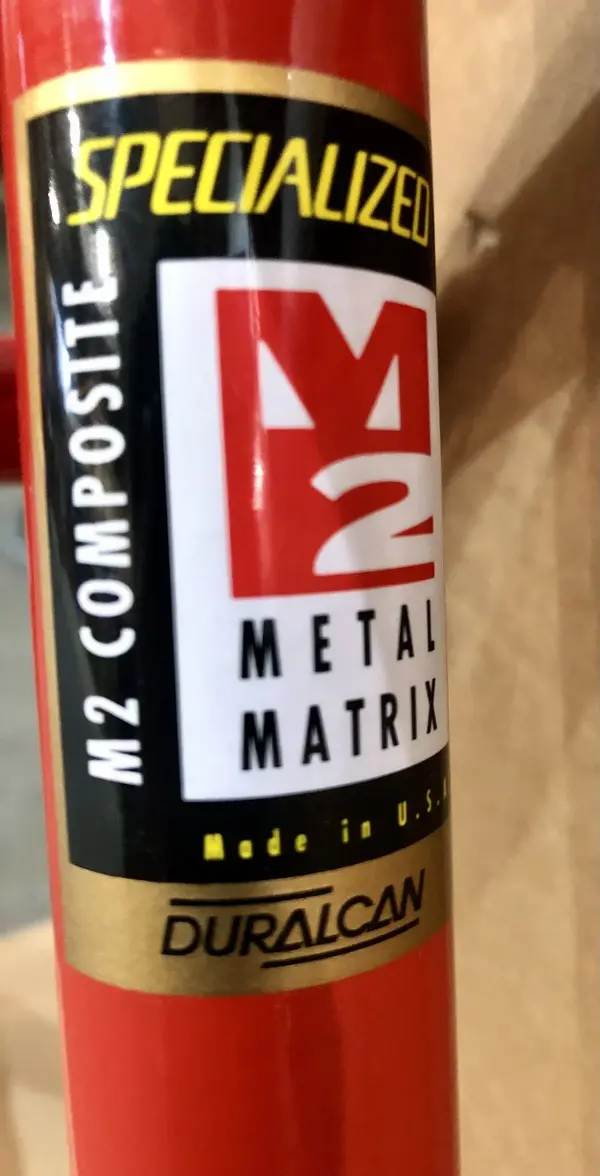

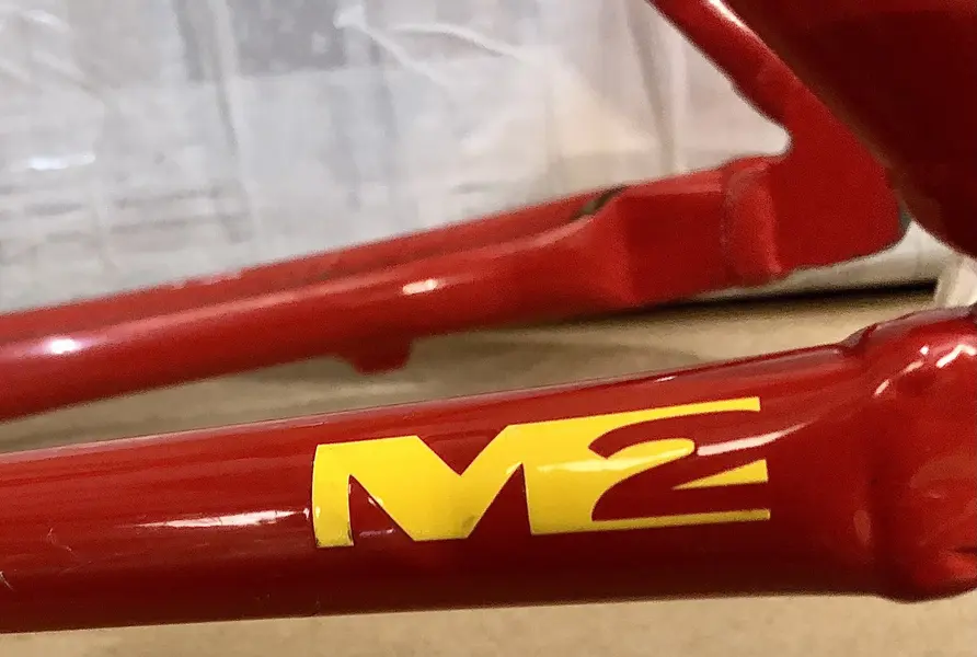

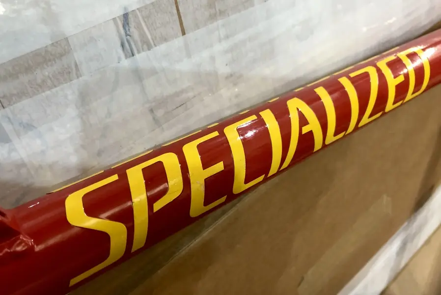

Not original, but old style decals — makes me think someone has mixed OEM decals from different years, or an eBay edition sticker pack. TT and DT logos are correct font but wrong proportion. Chainstay M2 logo is the 94+ type, not the fancy military font logo that it originally had. I wouldn’t doubt it originally being a Team Red S-Works though — maybe the paint was somehow obliterated by the late 90s and this was the best the owner could do to restore it?
I purchased this frame at the end of last year in northern Italy. I initially identified it as a 93-94 M2 but the paint scheme is special. The previous owner told me it was the official bike of an MTB team from Biella, Team Zola. The team was sponsored by specialized and Zola itself was one of the first specialized dealers in Italy from 1988. The paintwork and decals are the S-works division one but the production number (90T00074) suggests this is one of the very first frames produced in 1990.
I've been trying to better identify the frame but right now I'm stuck with the investigation. I hope someone has some info about it.
For now, the only hypothesis I can make is that the frame was Unsold or archived (I've seen this practice with early production numbers in many bicycle manufacturers) and later issued for this small team in Italy. Or maybe it was aesthetically renewed for the team, this hypothesis does not convince me because I don't see the point in changing not just the decals but also the colour with a complex chromed finish.
Another thing to note here is that the fork is a 1993 model Future Shock, and appears to be 1” threadless. It would have likely come with a steel or aluminum (Kinesis?) rigid fork, or maybe an early prototype of the 1992 Future Shock (like the black/orange/yellow one shown in a catalog). My opinion: source a gold 1992 Future Shock and use that. Build kit wise, it was probably equipped with XC Pro.

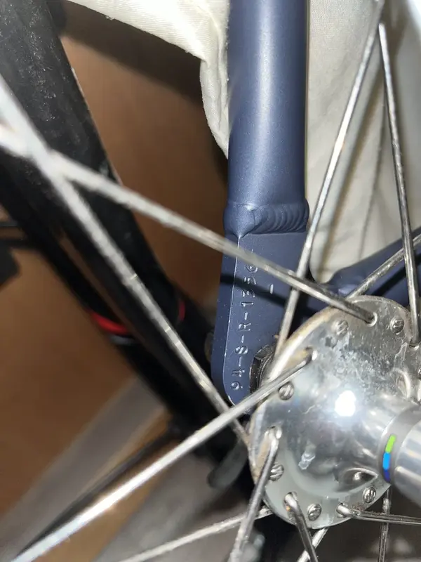

The first two digits of the serial number denote the year of manufacture (e.g. 96 = 1996). There seem to be some discrepancies (my 1991 bike is stamped 90), but it is mostly consistent with the model year. The letter indicates model. A similar format was used on FSR models of the time period. From what I can gather, S means Stumpjumper and SW means S-Works. The last several digits seem to indicate the production number.

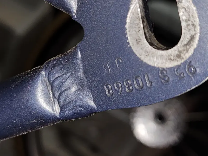

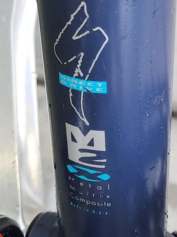

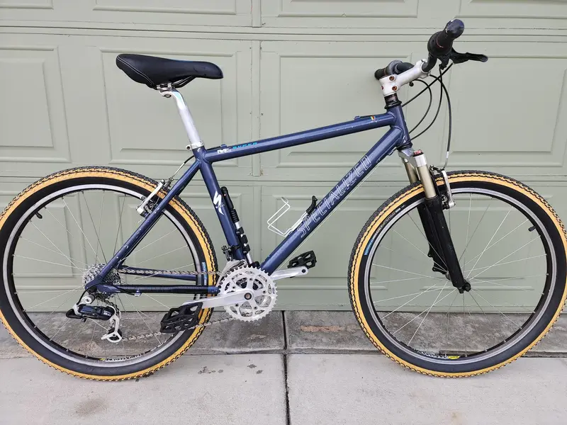

Hey Neko.
I believe this is a 1995 s works. I have the original Manitou sx ti fork. Any idea the value of this?

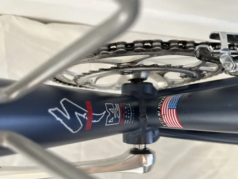

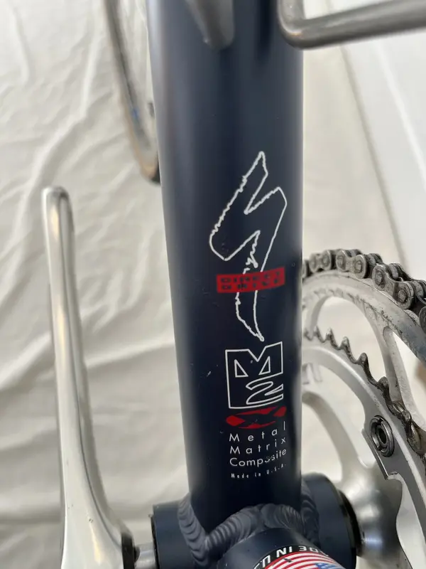

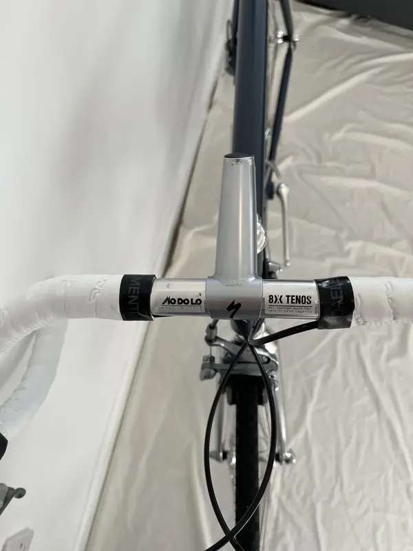

Hi, this is my 94? M2 Road. Love this bike very much. Stiff as anything and super fast

Hey Neko.
The original fork would have been a Judy FSX Carbon which came with the frame. It is a 1995 M2 Super.
Thank you!
Thanks so much for your reply. Are these still sought after or worth anything?
The FSX forks?! Heck yeah! The bikes… well, yours is a bit rough, but being an S-Works increases its value substantially, and it’s got some sweet parts on it. If you wanna sell it, throw it up locally for about $350, or 280 pounds .07 ounces (or however British money works). Or mail it to me for free 😉
