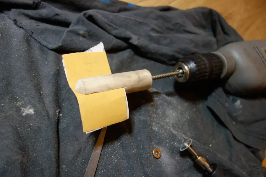

Seat tube sander

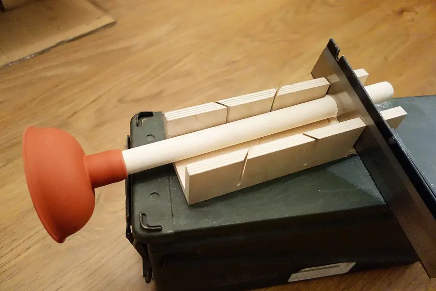

This is what I use to ensure the ends of hydraulic hose is cut at exactly 90 degrees. And when I say exactly, I mean exactly.

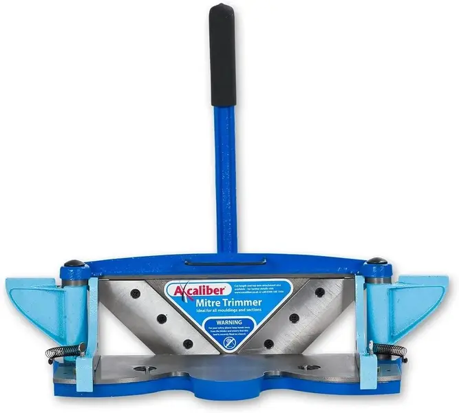

Achieved by first using a pillar drill to put a 5mm hole in a piece of timber, which I then use the razor sharp blades of this mitre trimmer to shave off a smidgen, taking the end of the ragged hose with it and leaving the end flat and true ready for the fittings.

Seat tube sander

For the "Seat Tube Sander" you can use another piece of the wood there, drill a hole through the center completely through then stuff scotch brite or steel wool in there and "polish" the inside of the seat tube, head tube or BB housing and threads.

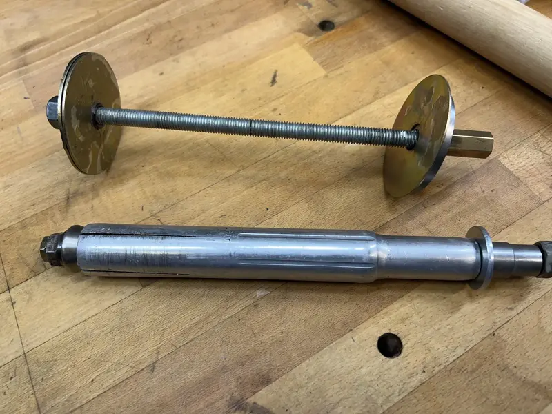

Makeshift headset press and an expanding cup remover. Screw in the cone from the other end and the cut seat-post expands so it butts up nicely to the head set cups. I call it the Butt-Plug.

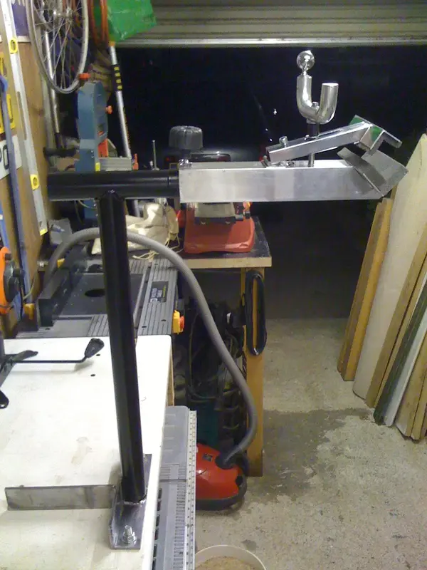

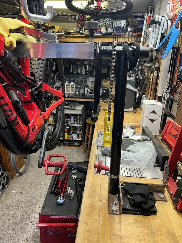

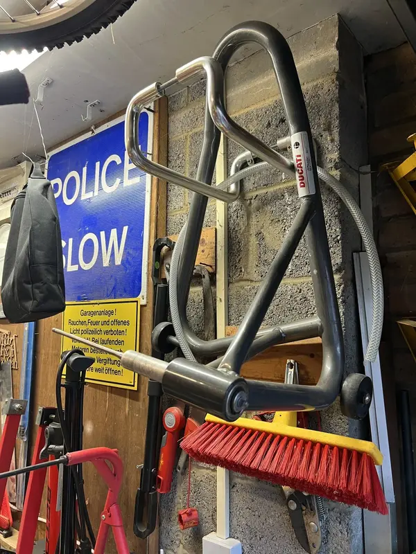

Modern bikes - BB thru axle stand. Modified from an existing stand with some light welding to add the gusset brace. It will just about support
my e-bike.
Heavy Duty version for e-Bike, made from a Ducati stand that some bloke was throwing away at the tip.
I added the thinner bar to the main motorobike sized axle tube thing.

Makeshift headset press and an expanding cup remover. Screw om the cone from the other end and the cut seat-post expands so it butts up nicely to the head set cups. I call it the Butt-Plug.
my e-bike.

love all these!!! What idiot chucks away a Ducati paddock stand??? I guess someone who had a Ducati!!! His/her stupidity is your gain! 🤣👍
