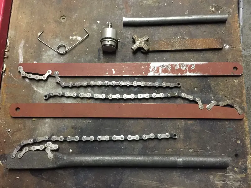

Great thread! Here’s some tools I made back in the early 90s as a teenager and still going strong today:
TOP (Left to right)
Chain keeper made from a spoke
Freehub injector tool to clean/purge and regrease freehubs
Simple tube scavenged and cut to length for added oomph/leverage for Allen keys
Quick homemade freewheel tool to remove brothers BMX freewheel
BOTTOM
x2 chain whips using left over chain and 6mm plate.
x1 chain whip from tubular steel with pressed end and poorly knurled handle (knurling tool was knackered!) and left over chain
TOP (Left to right)
BOTTOM

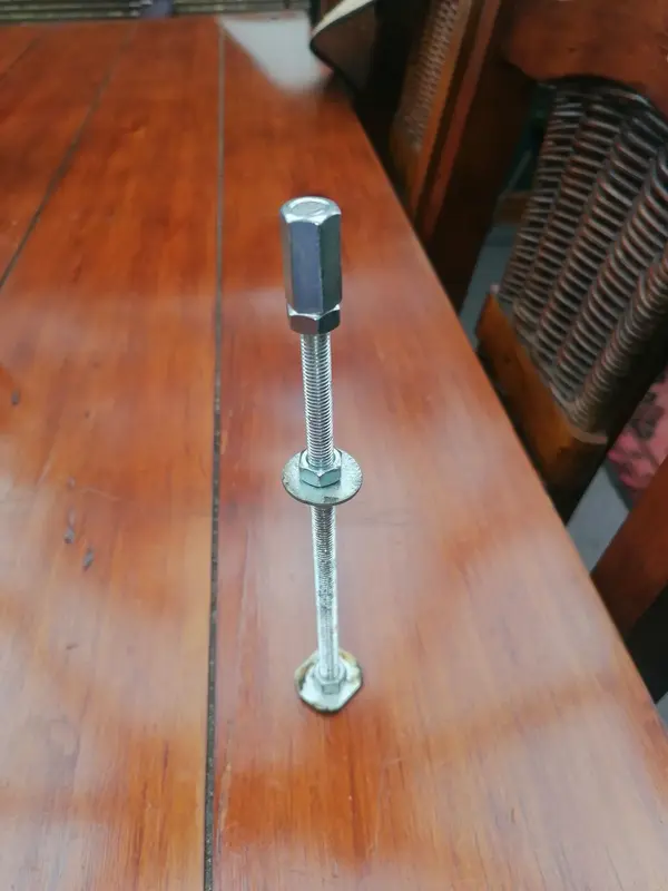

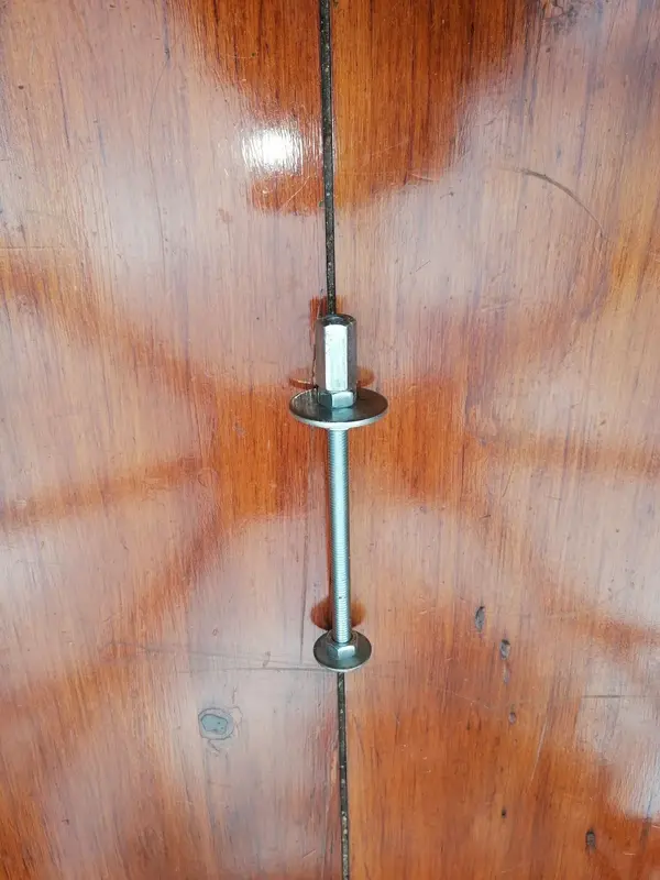

I knocked these up. On the "out" tool the washer that does the work is like a rectangle with rounded corners, allowing it to slip into the head tube at the same time spanning the full width of the cup on 2 sides when in position. This helps ease the cup out evenly. tap and rotate a bit, tap and rotate a bit more... The smaller washer keeps the tool vertical.
The "in" tool is more straightforward. The small washer goes in first to help even out the pressure. Tap, tap, tap. Bingo!
