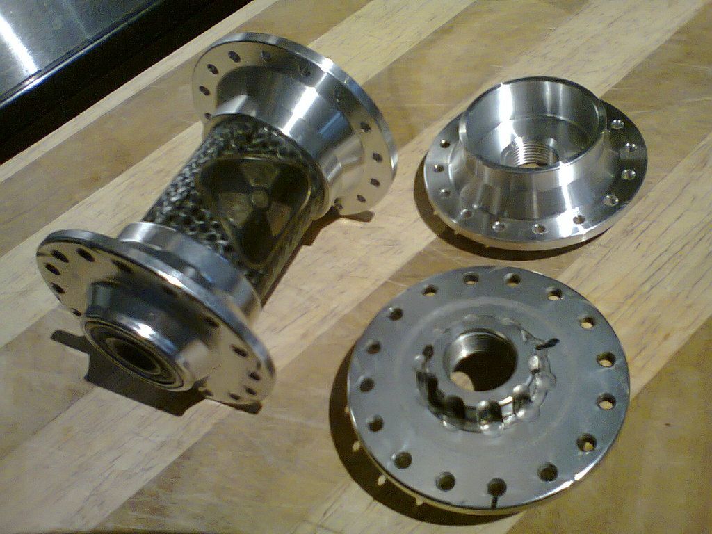

I had a broken hope front hub last year. And did a repair on that one, because they sure are pretty.
This is a picture of the replacement flange I made:
Had the same problem with a rear Nukeproof hub drive side , but still driving strong :D
That is impressive work. How much effort was it to make? Could there be a nice sideline in fixing broken Hope hubs?
