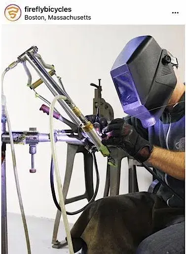

There is A LOT that goes into making a great all rounder Ti frame and it all costs, you get what you pay for yada yada. I was obsessed with Ti early on and rode lots of the early ones, inc certain well loved brands but they could be bl00dy scary on desents with speed wobble so you always had to feather the brakes. An overly flexy BB during climbing bugs me too but for general flat riding most Ti frames are perfect. Most of us dont push these bikes that hard anymore so its a moot point.
