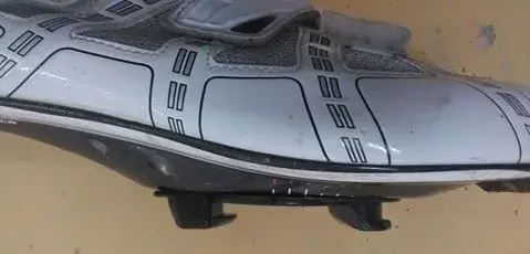

no matter what adapter you use there needs to be enough thickness for some material under the square look washers , the washers them self and the screw heads
Anyone know the latest iteration of Sidi shoes that used the recessed adaptor plate for different pedals? I have a pair of Sidi Genius 2 that have them but they're a little tired.
Thanks

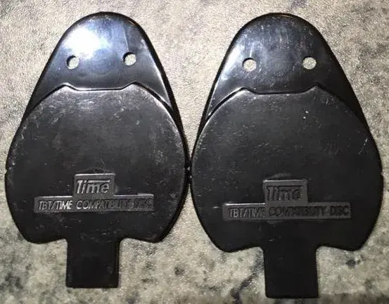

only the plastic Time disc to protect the carbon outsole . edited to say these are the black painted alloy cleats that were supplied with the 1st gen Titan Magnesium pedals
Unfortunately the discs are like unicorns. I haven't seen any on the ebay in 2 years of looking, although if anyone wants to sell some.. :)
