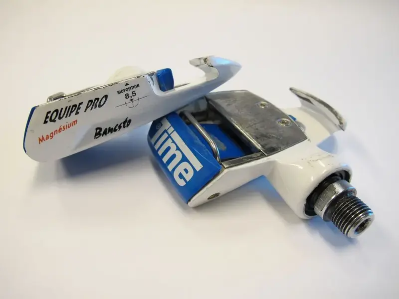

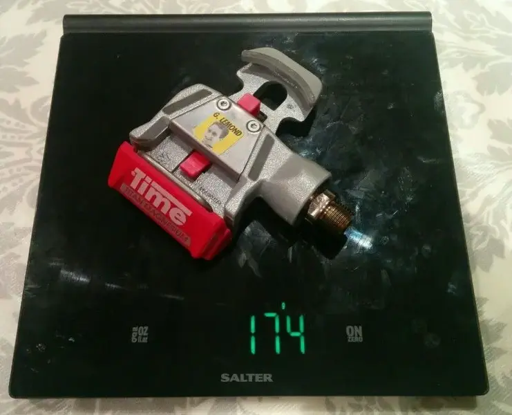

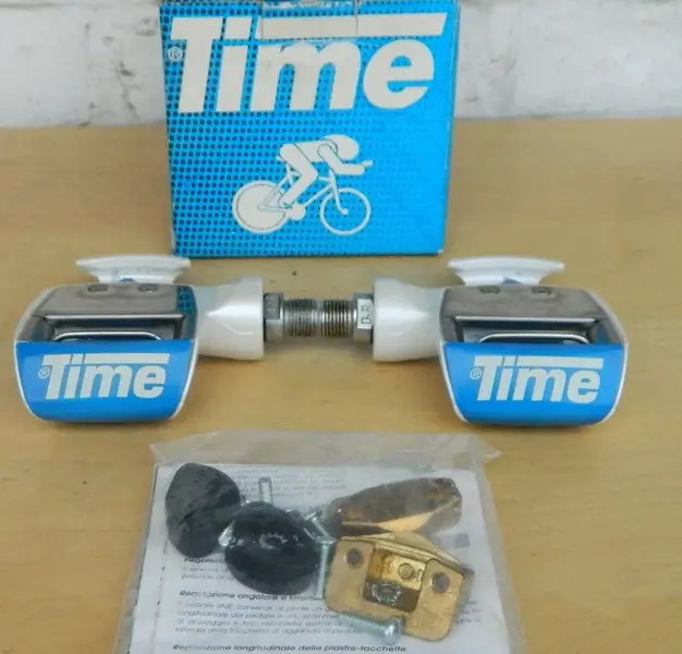

there was a blue/white banesto set with Magnesium bodies
