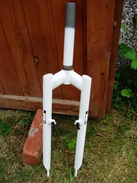

The On-one ti forks are quite burly and very stiff, don't think they make them anymore though. :(
I have a set of the white steel superlights (disc and V) in the garage that I could possibly sell, unless you want new in which case the latest forks from on-one will be too long.
I really like the On-One Superlights (I have an older, rim brake only pair plus some Planet X Knifen forks that are the same), they look great and are really stiff and solid. But the latter part of the sentence is the key - 'superlight'? I don't think so.
I thought the Knifen were a bit heavier?
Anyway, I weighed the "Superlights" 2.5lb is what they came out at, not bad I suppose and they are good forks, nice looking too.
These have a 190mm steerer and are 415mm a-c so OK for older bikes.
