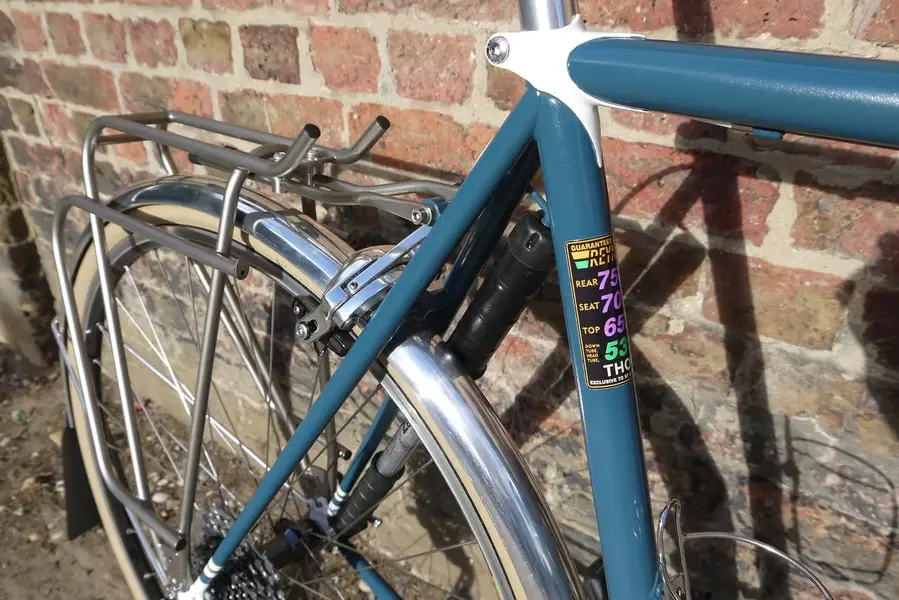

I had time to take some half decent photos today, hope you enjoy them.
Closer look;
Rack and pump details;
Headbadge;
All important Reynold sticker;

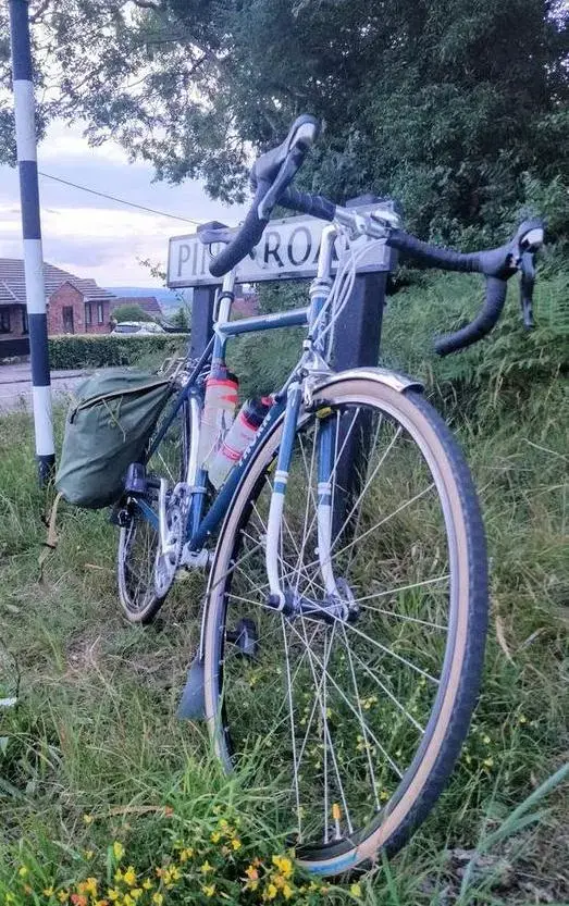

Finally, here we are in the middle of the Chilterns last week!

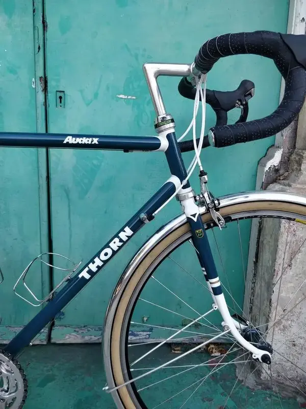

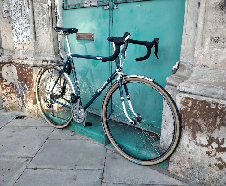

I have recently bought a Thorn Audax mk1 24 years old. Almost mint condition. Love it. Definitely more responsive than a standard 531 or 631 and just as comfortable. 20211230_163014.webp
Wow, good find! The condition looks fantastic as you say. Certainly better than my frame when I got hold of it. 😂
