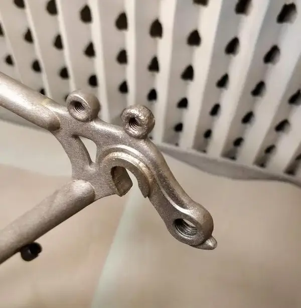

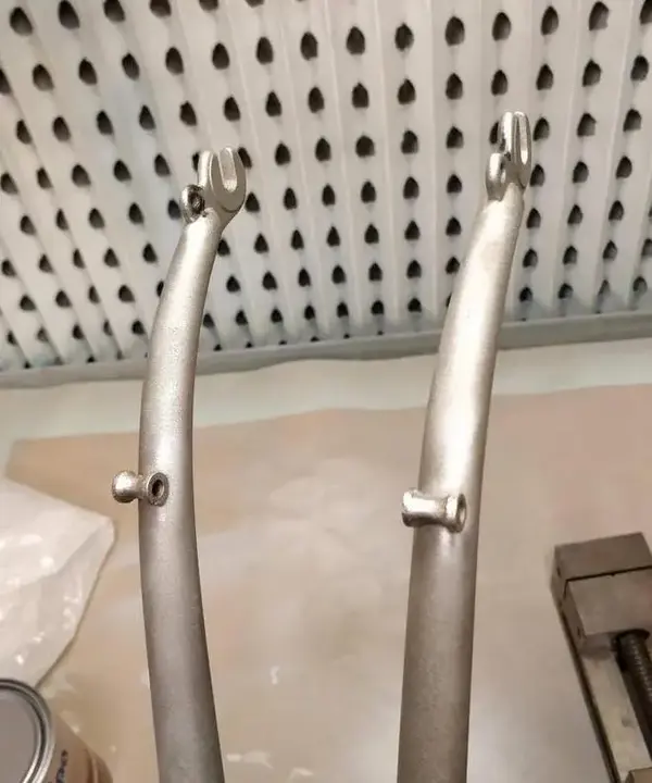

Going to be an elegant, functional bike. How did the rack mounts clean up with blasting?
Really well. Bit of pitting on the rear dropout mounts but the rest look grand;

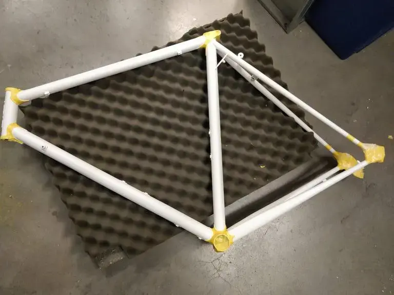

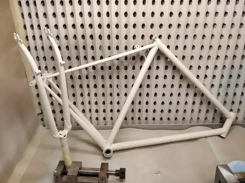

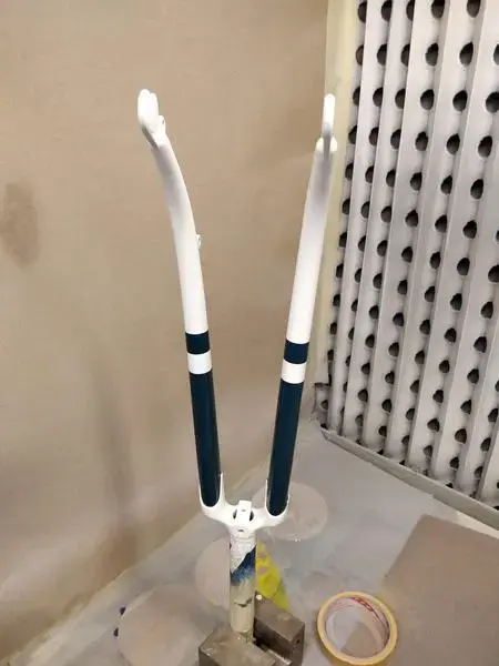

Been in the booth and finally got some paint on the bare metal, a coat of etch primer and the first coat of white... :mrgreen:
I'm going to leave this to cure for a few days and come back to it next week for the blue which should have it looking a little more exciting.

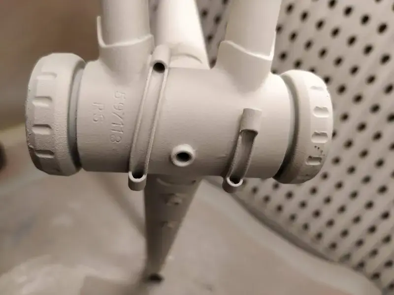

The old BB cups are just to keep paint off the threads during this phase.
Does the serial number mean anything to anyone? Built in 1997 maybe, around the right period?

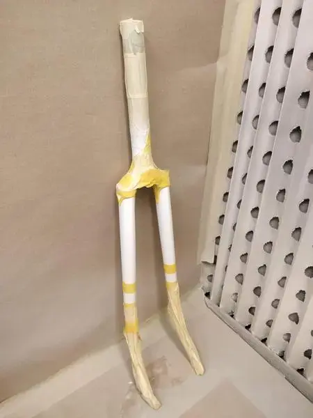

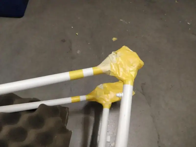

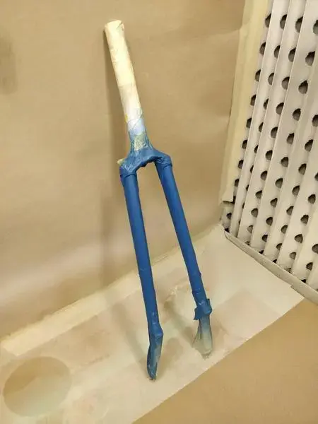

Big paint update for you all. After a week I was pretty happy to get the main colour on this afternoon. First I had the horrible job of masking the lugs which is not something I'd wish on my enemies. If you have a bike with contrasting painted or chrome lugs then yeah... be grateful to the painter. ;)
I also masked the dropouts, bands on the fork legs and the logos.

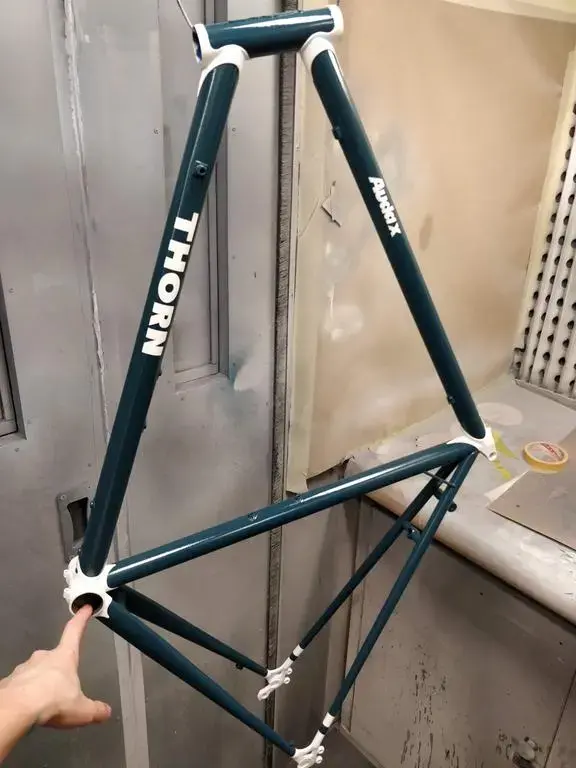

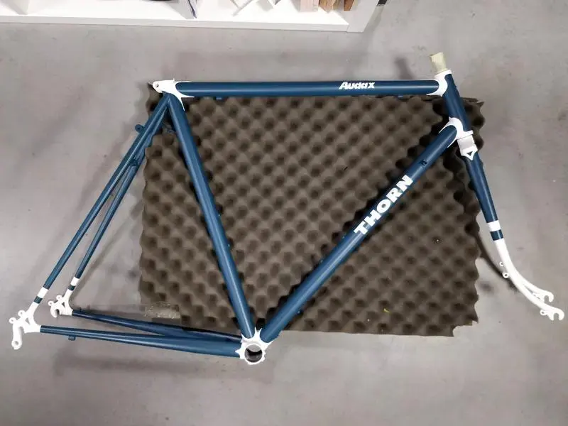

The first blue I mixed for this I got as far as spraying the fork before I decided I really didn't like it, it felt a bit flat and too similar to the original colour of the frame. I mixed up a teal blue/green instead, keeping it quite sober but I think making for a good contrast with the white lugs and text.
This image showing the frame and fork together isn't quite true to the final colour, the others of them separately are more accurate (at least on my monitor).
After demasking the white I tidied up some of the lug edges with a scalpel and brush and finished up getting a first coat of clear over the whole lot.
I have the Reynolds decals to go on before a final coat some time next week, and I was also toying with the idea of doing a gold stripe on the banding/forks somewhere. Maybe that's too much though, gonna sleep on it.
