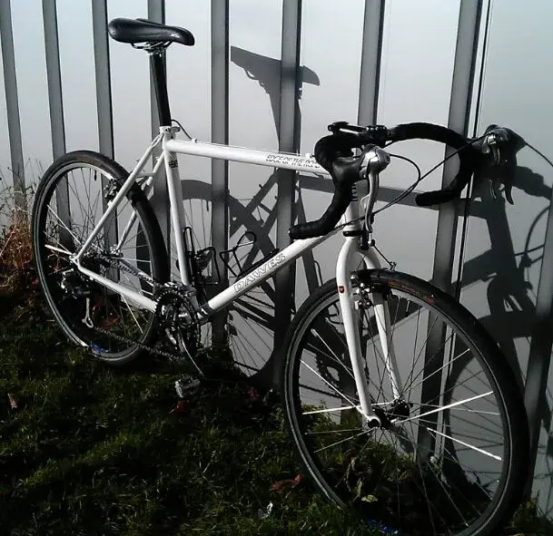

I've just finished a '92 Dawes The Edge. It's in complete road spec, cos i'm a roadie. It's got late 90's RX100 road STI levers, an XT M739 rear mech and an Alivio front mech i got from Chain Reaction for about a fiver. Took me a while to get it all set up(had some chainline issues), but it's spot-on now. As Le Grande Fromage says, can be a pain, but is possible.
Regards
Marge

I watched the assembly of your bike Margie and thought it was one of the most imaginative builds I have seen.

Glad you like it. In a way, it's a parts bin special. I'd been collecting components for a few years, and wondered if I'd ever have enough to build an entire bike. That it came out as well as it did sometimes amazes me.
I have plans for it, when funds allow. It really needs road cranks, with a 53/39. This will necessitate a road rear mech; would love to find an RX100 to match the levers. Finally, I've always wanted a CX bike but couldn't afford the £600-700 you'd need for a bottom end bike. Fortunately, Schwalbe make a CX tyre in 26". Should be just the job.
