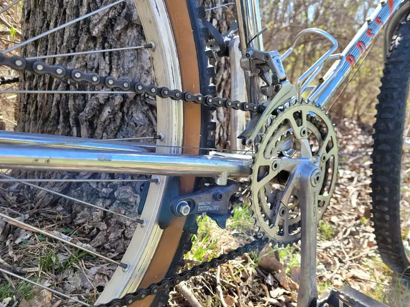

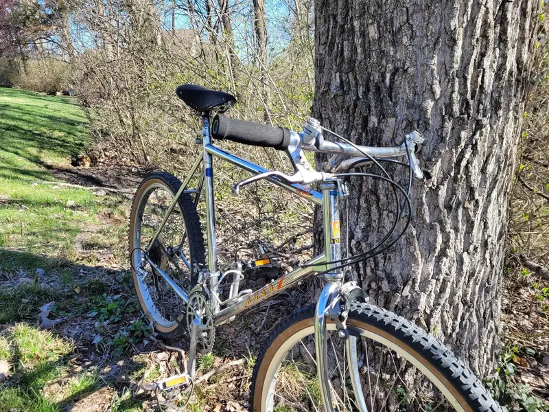

My, newly acquired 1986 Ross has them front and rear. My 1991 Zaskar has them on the back. Not much to say about them. The bike industry moved on for a reason. Cool for nostalgia sake.

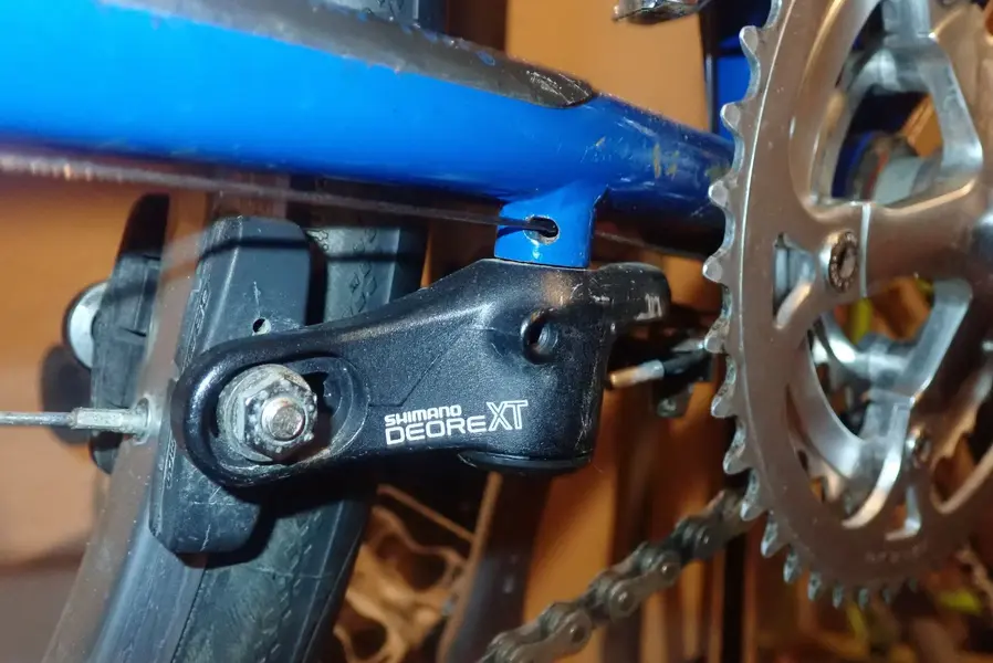

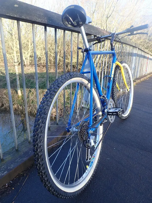

Got two bikes with U-brakes, Fat Chance with XT under the chainstay, and a Marin with it in the usual place, a late model to carry them but considerate as the frame is 17'' and u-brakes stick out less than cantis.
I agree about the clean aesthetic, the FC looks lovely from behind.

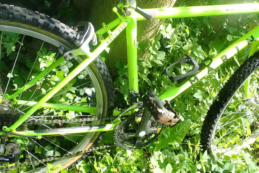

I bought a frame with front and rear U-brake mounts, but because I wanted to use roller cams which need the same mounts, sadl;y it was stolen before I got my hands on it. PA044215.webp P3120137.webp P5313228.webp
