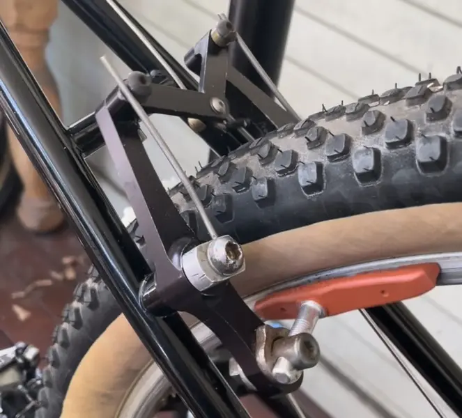

Who's got a McMahon Powerlink in their collection?
Any set-up and maintenance advice? I'm asking for a friend who somehow just ended up with two and is patiently trying to get one dialed in...
That looks trick. Can't offer any advice, but I suspect a few beverages will help you and your mate see it though. ;)
I wish we could post videos. I took a nice one of it in action this morning!
(Screenshot below at least.)
It took some faffing, but I think I got it reasonably dialed-in, in the end.
I will say, I found that much easier to do without the booster in the way.
It makes getting the correct cable tension a little too tricky.
My hope is that now it's set-up, I can re-install the booster, and tighten the springs back to roughly where I had them and hopefully everything works as well as it does now!

Mmmh. I think technically, that may not be classed as a U brake. God knows what it would be called though - Cross Link perhaps?
Like you say, without the brake booster is the way to set-it up initially to see that's happening, access the link and get the independent return spring adjustments right. I guess the flats on the silver AL spring parts are just wide enough for a spanner or at least a cone spanner when the brake booster is fitted.

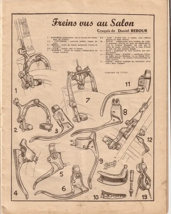

For your enjoyment, from a Paris bike show in 1952, brake number 7 from Bowden with a similar link system between the arms, interestingly the cable pinch bolt is set higher via another link.

Well, technically rollercams shouldn't be classed as U-brakes either, but we let those slide earlier and these basically operate in a similar fashion, where the cam and rollers are replaced with the scissor pivot instead.
I suppose anything mounted to a u-boss, which therefore pivots where it does, should count!
And yeah, the flats on the spring are for a size 13 cone spanner. The main issue tho, is accessing the tiny little, annoying hex bolt that secures the brake cable to the pivot. There's a tiny hole drilled in the booster, but that requires a scenario whereby the loaded tensions align bolt to hole just perfectly. And in all my attempts I couldn't make that the case. So off came the booster! Now the brakes work great, I just have to remove the bolts again, put the booster back on, reload the springs to approximately the same position, and all should be gravy....
