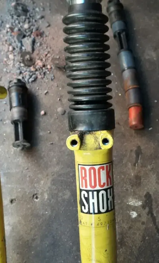

Whilst the newly found forks got a strip down and de-seize.

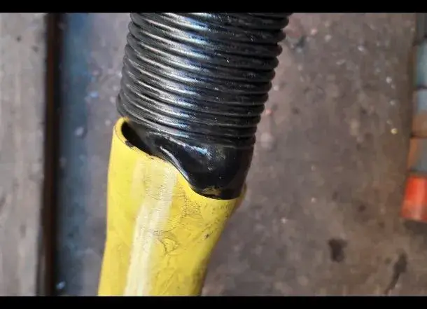

The rs quadra were locked solid. Once I took the brace off only one leg was seized.
Phewwww.....
The other side had some chain oil poured in below the gaiter and rotated..
....creak....more oil....rotate other way...slide up and down several times.
All is good!
The elastomer stack came out in one unit, from one side..the other a crumbling
mess of stuck-ness, ness. (Its int' dictionary) :wink:
Teased and ground it all out with a large flat blade screwdriver.
The rebuild will be a pleasure as I have elastomer rods. I like to tinker.

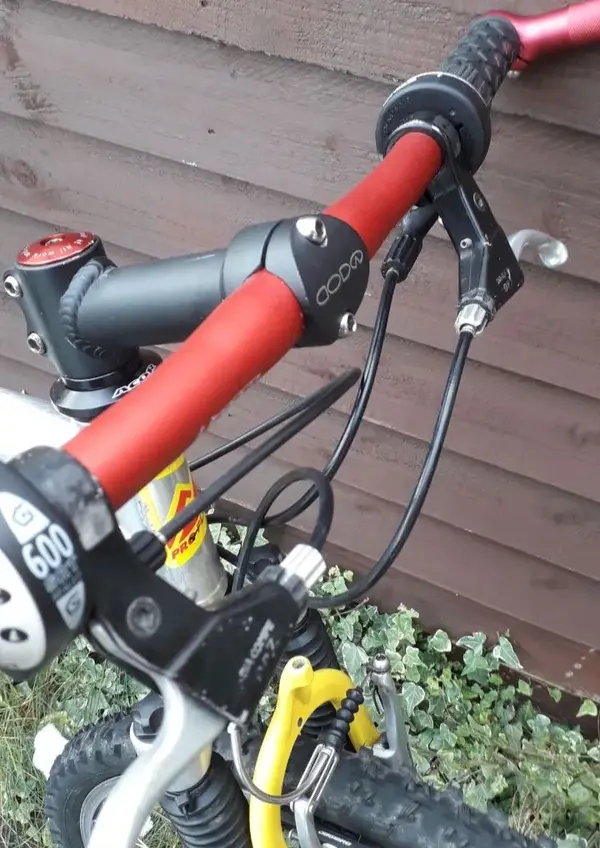

The alu finish is narrrsty, ratty.
From the catalogue spec, I'm not going to Paul, king, nuke proof and all that.
So, I plumped for red bars from China and cheap v brakes.
Not without consideration though, all is in good shape and worked on for condition.

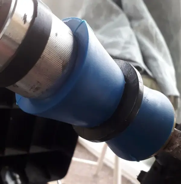

The rear shock has been revised with a boat keel roller and looks better and, feels firmer. I can only trial it all though.
