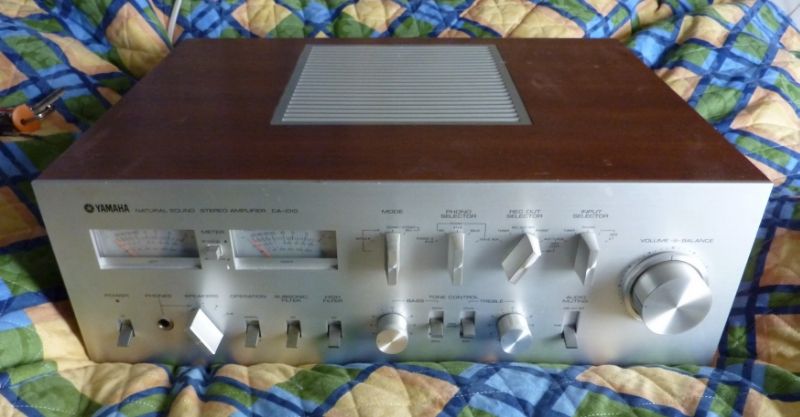

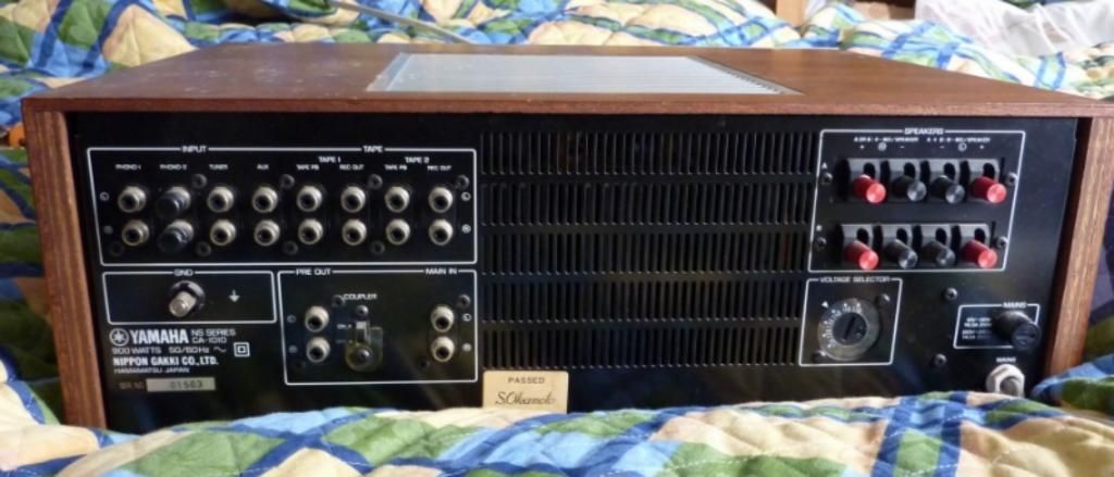

Yamaha CA 1010 (circa 1979)
Seems to have developed a crackle when turning volume knob, but I'm pretty sure that's an easy fix.
£100 (seen them go for more than twice as much)

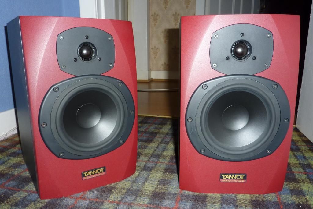

Tannoy Reveal 6 passive monitors £65

The yamaha is nice - the crackle can be cured by simply (and carefully) twisting the knob from side to side whilst turning it. Dust and teeny bits of corrosion build up causing the 'crackle'.
Dont use switch cleaner just yet as this can damage the internals on some volume pots.
But, again that Yamaha is very nice.

Thanks.
Can't really bear to sell it, but at the same time can't bear it not being used. If nobody here wants to buy, I might just hang on to it, but the Tannoys need to go.

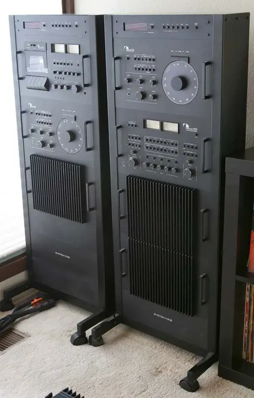

mrkawasaki":1q3emb66 said:
http://www.ebay.co.uk/itm/Nakamichi-System-One-1600610-Preamp-Control620-Power-Amplifier630-FM-Tuner-/380853297651
:-0
They look like they featured in the control room on the set of The China Syndrome, or similar to mainframe cabinets when I first worked in a mainframe room.
Probably take about the same amount of power, too...
Do you need Cambridge monitors on the wall to alert for temperature and humidity?
