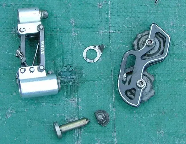

Not trying to throw a spanner in the works but I've had a root through the bag with all my mech bits in and there's a small washer/plate which has a 'pointed' sticky-out bit and a 'joggle' in the flat surface opposite it. It seems to fit onto the back of the top pivot similar to the ones Laz is making. Have I got something different from a later model perhaps - are there 2 different versions - or is it something totally unrelated?
I'll take a quick photo later and post it for you all to see.

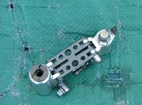

As promised, here's a couple of shots of the bits I've got. The first is of all parts and you can see the 'plate/washer' in the centre. It's different to Laz's one. The second shot shows it fitted onto the top pivot bolt where it seems to fit quite happily. The 'joggle' seems to take up the 'slack' between the mech and the dropout and the 'sticky-out bit' must rest against the notch in the dropout. I've not actually fitted this to a frame as yet to see.
Why can't things ever be simple!?
