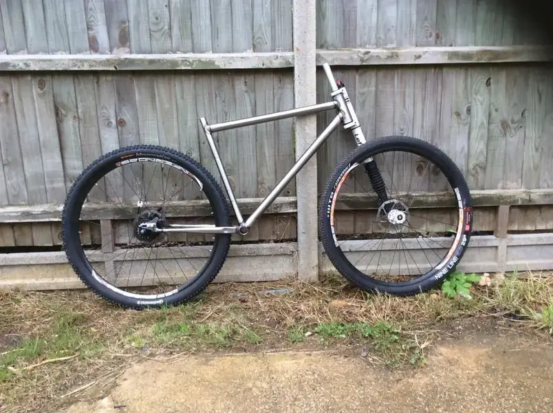

The build has begun
It's a 2.2 tyre and the wheel is all the way forward in the adjustable dropout.
It will be further back when set up and I will probably use a slightly smaller tyre.
This was the biggest tyre I could find to use for setting up purposes.

A couple of new pictures.
Nice bit of 853. Won't be long now.
Seeing the last pic I'm guessing your fairly tall.
Is that a tapered head tube, integrated or something special?
I have a similar albeit non custom set up. I have an Alfine hub for this but have always run it SS :oops:
I had planned to run a belt rather than chain but have read a fair amount about them being less than suitable for off road duties.
Look forward to finished pics and hopefully seeing it in the steel 8)
Mark, it's a 44mm headtube and has a Hope headset fitted,with the same Lefty kit that you use.
It was actually seeing your Skookum that gave me the idea for this build.
I am nearly 6' 2" tall, with a 35" inside leg so it needed to be fairly big.
The only bike to ever fit me perfectly was my Pace RC200 20" which unfortunately fell in half in February and this is loosely based on the dimensions of that so hopefully will feel as good, but with decent suspension and brakes that work.
I liked the idea of belt drive but have seen a couple of broken ones and I want this to be ultra reliable above almost anything else.
Just the cable guides and seat stay bridge to do. Getting excited now. :D
