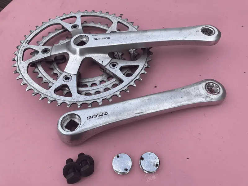

Another component choice made!  Thanks to
@raidan73  im now the prowd owner of a m730 chainset.  It needs a bit of a tidy up, but its really not too bad ( in my book).
Thank you....
XT is hardly a ground breaking choice, but its good quality.....if only modern stuff as as well made......and its relatively cheap.  This is especially true if your prepared to put a bit of elbow grease in!
First job is to relive it of its rings.  As its going to be a daily and the rings are a bit fried, im going to use a set of TA Zephyr/ Zelito i have knocking about.
Then into de-grease.  You can't polish anything that's greasy!

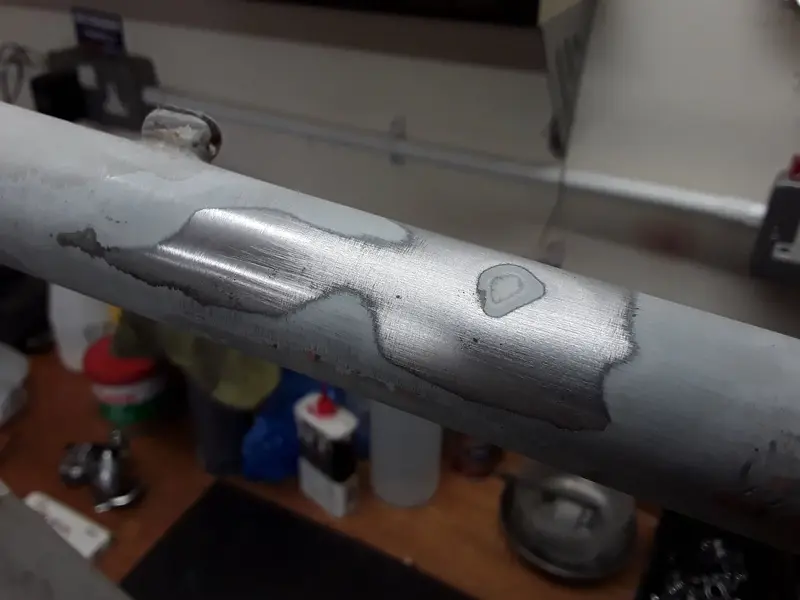

Today task is to knock the really rough spots, knocks, dents, serious heal run etc off.  For that im using dronco discs...it can all be done with wet and dry, but this is just faster.   BUT....a word to the wise, they cut fast!  If your not sure, don't start.....the window for this going south fast is huge!
The key is to cut in layers, you cant just take out the " bad bit" otherwise you will see a dent when its all polished up!
The trick to all this is, time.....and know when its enough!  You can't solve all problems and you have to know when to say "woah, stop the bus".
After another wash in detergent, it polishing.   Basically sisal mop with brown compound, then cotton stitched with blue, then loose cotton with a touch if blue if needed.......but that's tomorrows job.....along with some horrid condition cantilevers!
So that's 2 more bits off the list!
