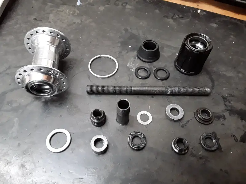

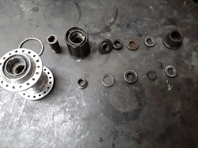

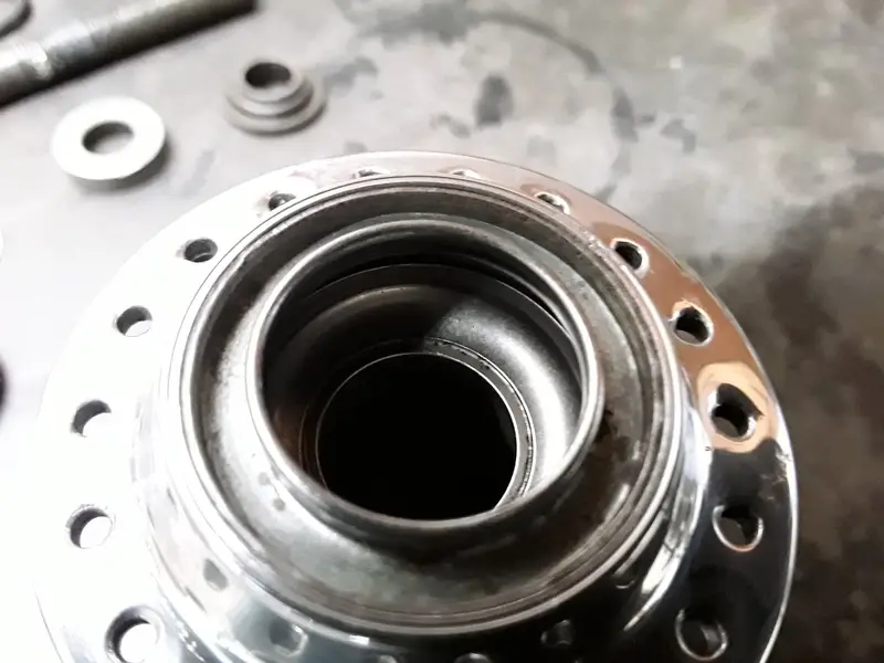

Having gutted it and found the missing bits....(i never know why people have to leave parts out when they rebuild stuff).....de greased it, filed out the damage, polished it and rebuilt it.....its great....lovely races, ready to go.

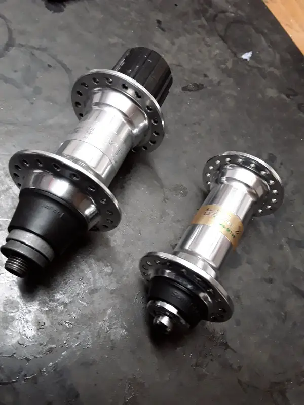

The front was an ebay find, but cheap as it was near perfect. Its actually the M738 which has a slightly thicker spindle, suspension fitting end caps (and a gold label). They were designed by shimano to cope with suspension forks which were becoming normal fare. They do however fit all normal forks, although being called "110", they are 100mm.....thanks for the confusion shimano!
