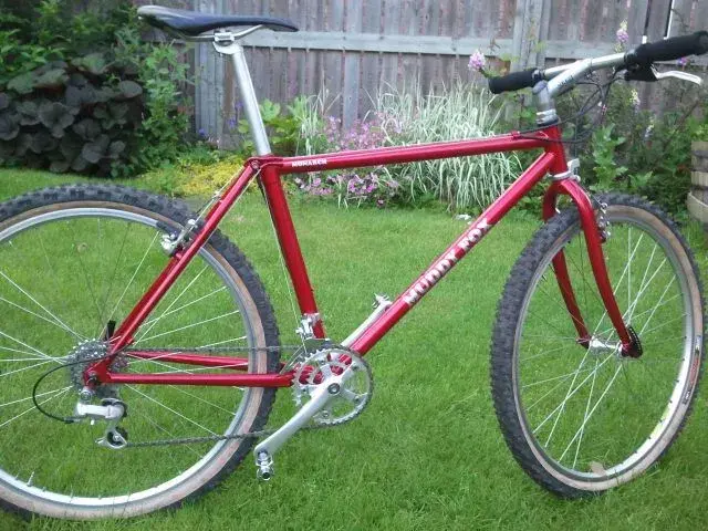

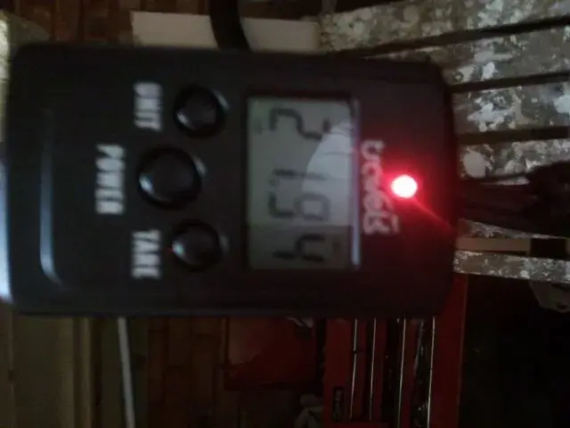

my Muddyfox Monarch comes in at 21.94. I have a 48t outer chain ring that took the weight to just over the 22lb target, but then i got a 38 for the front with the intention of running it as a double. I think 38 – 11 should be high enough for most circumstances. Once the stem & quill bolt have been shortened and seat post and other bolts looked at there are some bar ends to go on, or the 3rd ring will go on if i really can't live as a double. Quite happy as not a “boutique” part in sight. will only get lighter as the right parts come up. Frame came in at 1.8kg btw.
Tyres - mythos
Tubes – schwalbe presta
Wheels - Dx hubs 32 hole 3 cross to mavic x317’s with DT butted spokes
Skewers – spare set of bontrager ones i had kicking about, but might be ti, but they are proper lever type ones though
Block - unknown but its a standard 11 – 28 steel shimano
Rear mech – polished lx m550 with a short cage off a dx fitted
Frame muddy fox monarch – suggest fuji stout lite tubing?
Forks - what i had spare – came off a giant escaper so hardly high end but weighed in at 800g so not too bad
Chain – unknown
Bottom bracket – spare un71 i had
Cranks m900
Pedals – entry level eggbeaters
Chainring bolts - generic
Crank bolts – generic steel
Chain rings – tioga 24, TA 38
Front mech - m900
Headset – richey logic
Stem - zoom - unmodified with original full length steel bolt
Bars – x lite 535 ali – these are still over 200g though
Seat post –generic 27mm with plastic shim, steel hardware
Seat – halford own brand “bikehut” – but might be ti railed
Seat bolt – steel allen bolt
Brakes – m900 cantis
Brake levers m 900 which have had the pods sawn off
Shifters – dx thumbies
Cables & outers – generic.
