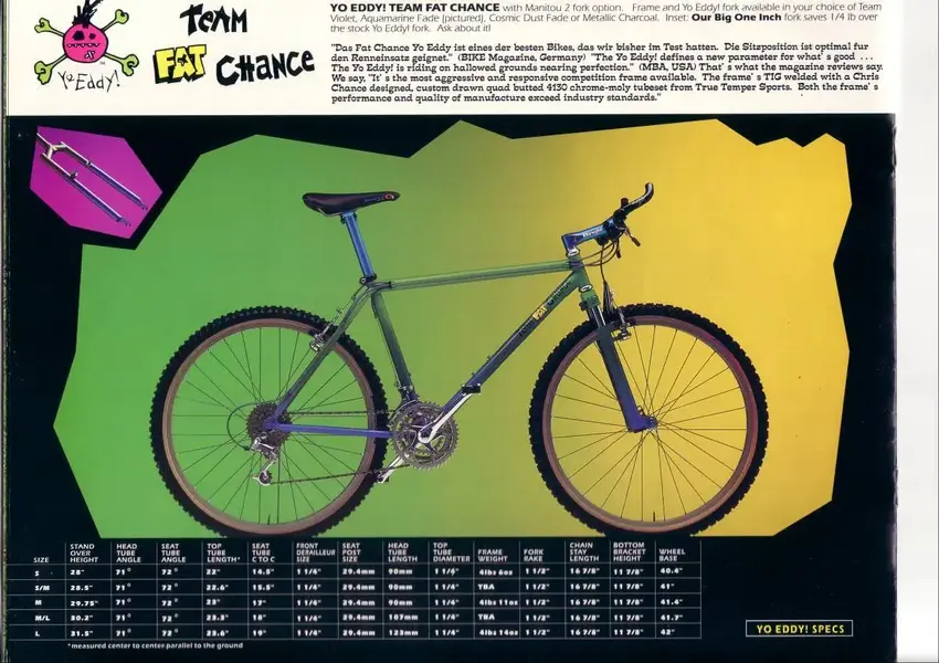

Anyways, I was after a full geometry/sizing spec on my M/L 95 Fat Yo! so I can check lengths/widths/diameters and start hoarding parts :twisted:
Strangely couldn't find anything on FatCogs [when it was up].. :roll:

Sorry Kingroon, best i can do is a spec sheet for a '94 Yo, any good?
Melvin, that's perfect, cheers mate :wink:
29.4mm, that was what I was after :oops:
Cheers B3 too, always good to see the differences between the years..
