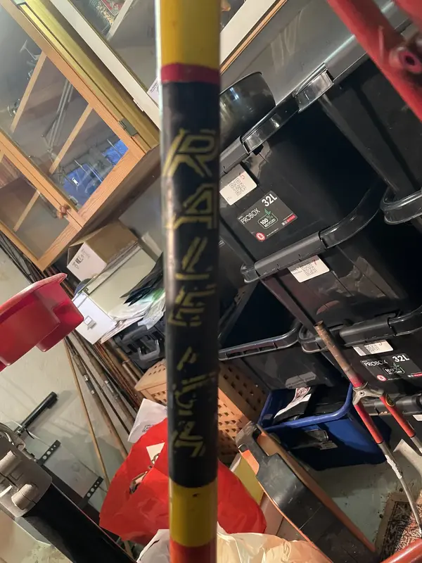

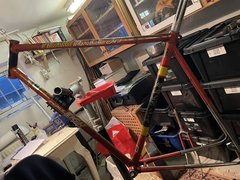

Hello experts,
Can someone please help me with a good place to source decals for this battered Raleigh, and maybe give some good advice in regards to paint or leave as be😫
Thanks a lot, it is pretty weather beaten……

The correct no black outline decals for 74 are not available but I have some original sets which I am considering having reproduced if there's a demand. You have the second version of the Ti Raleigh Team Livery used for one year only 1974 then the same style italicised font was used used with a black outline for the third version in 1975 . Preserve what you have as it's rare and only original once.
Agree with preserving the finish.
There will come a time when all the team frames left will sport fresh refinished livery, - often heavily done with poor colour matching and crudely replicated decals.
We’ll realise what a mistake we made when it’s too late, and original finishes will be highly valued and sought after.

I use a variety of scotch brite, wet and dry, cutting compounds and a good wax polish. My preferred wax is Mer. You will have to work around the decals. If you're worried mask them off. It's knowing when to stop and not "Gild the lilly"
These are very useful, use a rust converter after. Get a paint match after you've cut back a sample of paint.
