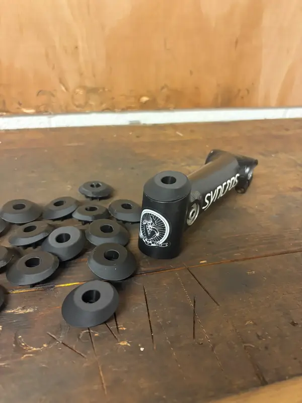

They won’t crack if they are not used for the initial loading of the bearings.
- use a different stem cap to load the bearings
- tighten the steerer clamp on the stem
- remove wrong stem cap and fit repro version
Same principle with the originals too ;-) especially if the headset, stem, steerer isn't new.

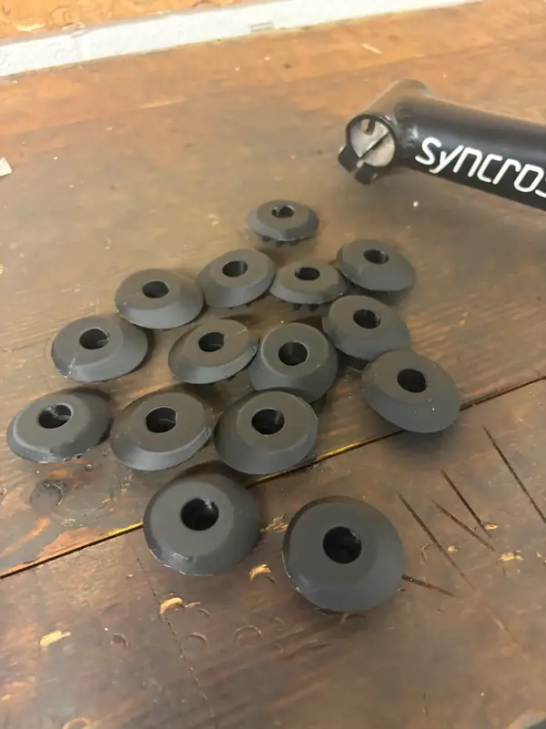

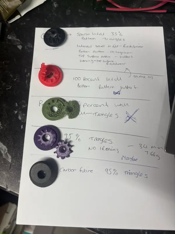

We experimented with different variations (which mean nothing to me). Think around 10 were tried. And still experimenting today
Some failed by cracking , and some failed by being too soft.
To be on the safe side I’d recommend preloading with a metal cap and then add this decorative cap on afterwards.

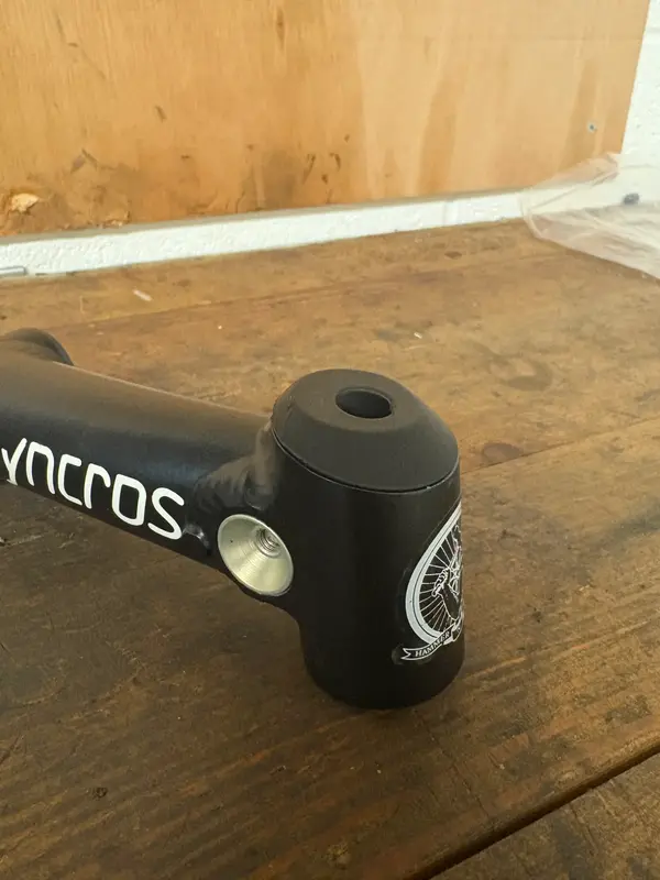

However they do work to preload the bearings fine. If you continue to tighten them beyond that then of course they break. But the standard plastic one would do the same too.
After a few hours of printing and testing we are happy with the final version.
You can tighten a headset way beyond what you would to preload bearings (to the point the headset locks) without the top cap breaking.
However as a disclaimer I’d say that you need to use a metal cap to set the preload and then replace with this decorative top cap to finish.
Printing another 15 off today so they are going to be available from tomorrow
