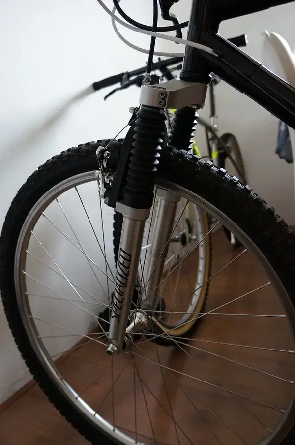

Anyway, I was lucky to find in the basement another Future Shock with the same internals. It's a newer model and it was sold as the SE (I think as the Future Shock Sport in 1993/1994). Mines like that except with different lowers, it the very first version that came to market in 1991/1992. So I tested the SE fork and that one kept air... so I switched valves from this fork to the other and the problem is sold. BTW: the valves are just aluminum kinda mushroom like tubes with a rubber internal inside, the exact same ones are in my RS-1 fork, but I didn't want to take the valves from that one :oops:

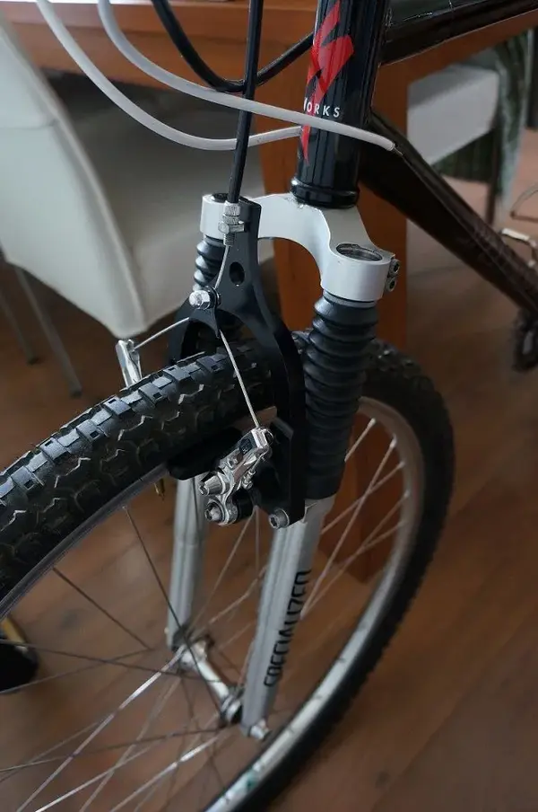

Here's what it looks like (I very much like the staged lowers):
The brake arch is one I found somewhere and I actually saw it in an MBA from 1992 (or 1993). It's called STOP! and it was an aftermarket brace for the RS MAG-20... never seen one anywhere (on the net or in real life). I like it, very beefy brace and very little flex while braking :-)
I also have one of these with adjusters, that fork was a replacement for my 1992 StumpJumper FS bike I bought from new back then. It originally came with the above fork (it's in my S-Works Carbon) but when the seals started leaking I'd sent the fork back to Specialized Benelux and got the adjustable one as a replacement :-)

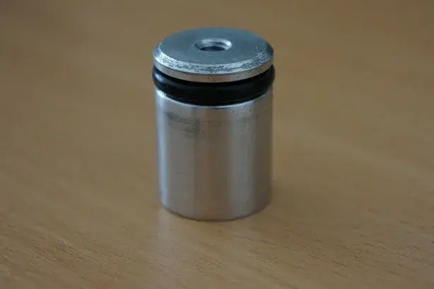

Do you have a picture of the valves. There are two type, the 8mm cyclender plug and the same thing in a plastic case as used on mag30 and 93mag10s
Which are much harder to do.
If the metal recesses to a valve like the mag10 the tyre valve setup works really well.

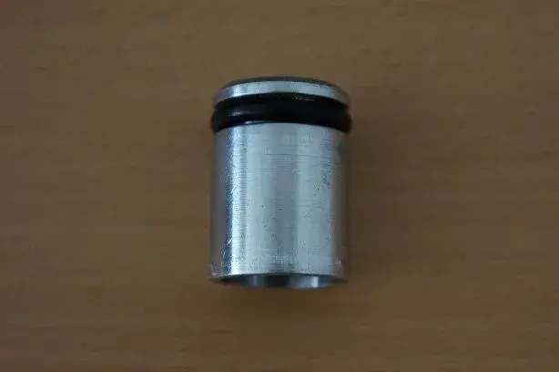

It's these ones, the exact same ones are in my RS-1 fork:
