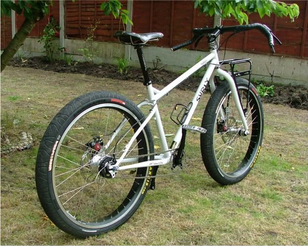

The risers are DMR wingbars but they are only on to keep the brake levers on whilst my Titec J bars are being polsihed
Liking that Hope rear hub as well - going to be a smart build 8)
Not updated this for ages due to a pretty hectic few months, new baby, house move, work load etc.
Anyway here she is 99.5% completed, just need to tinker with the gear hub and stick on the big boots but they can wait until later in the year.
Build details as follows
Frame: Surly Pugsley (small)
Fork: Surly Pugsley.
Headset: Chris King Nothreadset
Stem: Thomson Elite X4 110mm x 10 deg
Handlebar: Ragley Luxy
Grips: Brooks leather bar tape
Brakes: Avid BB7 (mountain) with 205mm G3 Cleansweep rotors
Brake Pads: -
Brake Cables: Goodridge braided
Cantilever cable hangers: -
Brake Levers: Tektro RL520 drop v levers
Shifters: JTek Alfine bar end shifter
Front Derailleur: n/a
Rear Derailleur: Alfine 8 hub
Derailleur Cables: Goodridge braided
Cassette: Rear - Shimano Alfine 20t. Front - Chris King King Kog 16t
Chain: SRAM 991
Cranks: Middleburn RS7 Isis
Crank Bolts: n/a
Chainrings: Surly ss single speed 36t
Chainring bolts: Shimano
Bottom Bracket: FSA Pug specific 100mm
Pedals: DMR V8 clone
Hub Skewers: Hope ti (front only)
Rims Surly Large Marge dh 36h offset
Hubs: Hope Bulb 36h ti front, Alfine 8 36h rear
Nipples: Sapim
Spokes: Sapim stainless
Tyres: Maxxis Hookworm 2.5
Tubes: Michelin dh
Saddle: Brooks Swift Ti, black
Seatpost: Thomson elite 27.2 x 330
Seatpost Binder: Thomson.
Rack: Old Man Mountain front, rear to follow.
8) Sweet!
