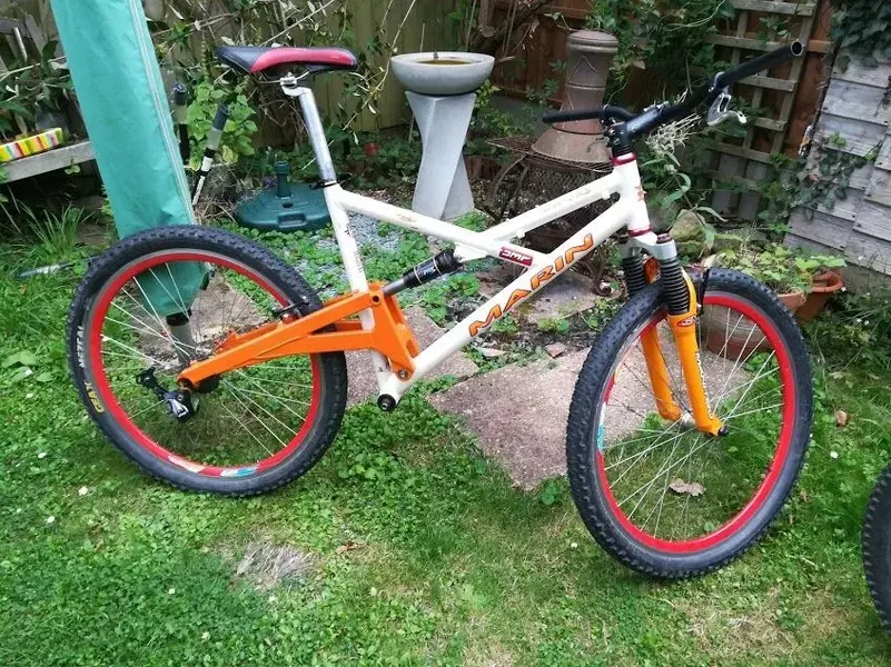

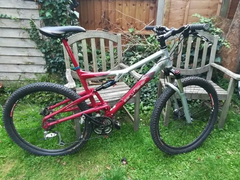

The Fisher is functional but just a bit dull
whereas the Marin encapsulates the late 90's mtb spirit and is as daft as a brush but needs allsorts
but
which to keep...?

Not a fan of GF on the whole, but it is complete and built as should, so only you can decide if you like the ride.
The Marin has a place in my heart having owned a Team Marin DH complete factory spec bike when it first came out in '98..... Damn that thing was a head turner with the red biguns, X-Vert Carbon fork and Hope discs, and yes the Marin is nice to ride! However the example you have there is somewhat confused as to what it is supposed to be..... It appears to be a DH frame trying to be a Mount Vision with XC shocks and travel? The frame was designed around a 150mm fork, and a coil shock giving approx 160mm....... This one has (iirc) an 80mm fork and an RP3 giving who knows what..... I'm also a little confused by the swingarm as it has I.S tabs like an XC Marin or possibly a '99 B17, whereas the DH version had the post mount and adaptor for a number 1 caliper (Hayes fit?), So maybe it's a DH front end bolted to an XC swingarm and hance the XC shocks....... So maybe not apples & oranges afterall, more apples & pears?
Personally I'd build the Marin but with a different fork, If you don't want to go triple clamp, at least a 140/150mm Bomber or if you're feeling brave something like a Pace RC41 150mm.
What's the eye to eye & stroke on that rear shock? The Original Fox Vanilla TC was 200 x 57mm iirc.
The swing arm is original, it had a disc tab added.
The forks are just forks that match in colour. The shock is 200mm whereas the Mt. Vision is 165 and hiding in the shed.

Yeah I know the difference between the models, but unfortunately from a pic its hard to tell exact measurements and hence the question re shock length, So if it is 200mm eye to eye then it definately needs a longer fork!
With regard to the swingarm, you say the I.S mount was added? So what happened to the original post mount and adaptor or did it not have one?
This is how it looked before LGF got his hands on it. the post mount was removed and the is mount added as it is difficult to find the adapters nowadays. The bike rode really well with 120mm forks. it was a good all rounder set up like this and kept up with the best of the new stuff.

Until the Fisher has a new hub or wheelset, it will be the mishmash Marin as soon as I can get it built (with longer forks)
From the pictures the GF seems to have a longer top tube which I feel would be an improvement in the ride.
Trek shaved a few pennies by not fitting bearings in some of their FS frames and used something less sensible instead. If this is the case with yours I would stay with the Marin as it is a well known and liked product on here.
