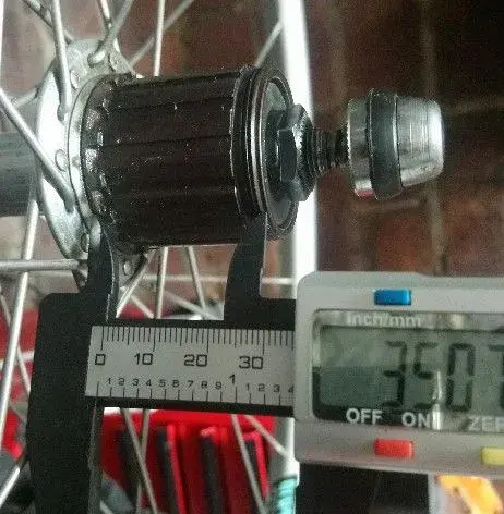

Just had a measure and confirmed that the one with the shorter body is a 7 speed MD and the larger body hub is a 7 speed standard, now both available for sale.
Kingofthescrathchmonkeys, Matt, has very kindly offered to take the 7 speed standard hub back, I bought it from him and he had offered a return if it wasn't the right one for me, he currently has a sale thread up for it, it is new/unused with just the light marks as shown in his photos.

I've got some wheels with XC Comp hubs, the rear looks to be a standard (ie. Non-microdrive) 7-speed Suntour cassette body... Where the hell do I find a cassette for it??
The freehub in question...
I might have an 8 speed free hub and cassette. If interested, let me know and I'll locate them.
