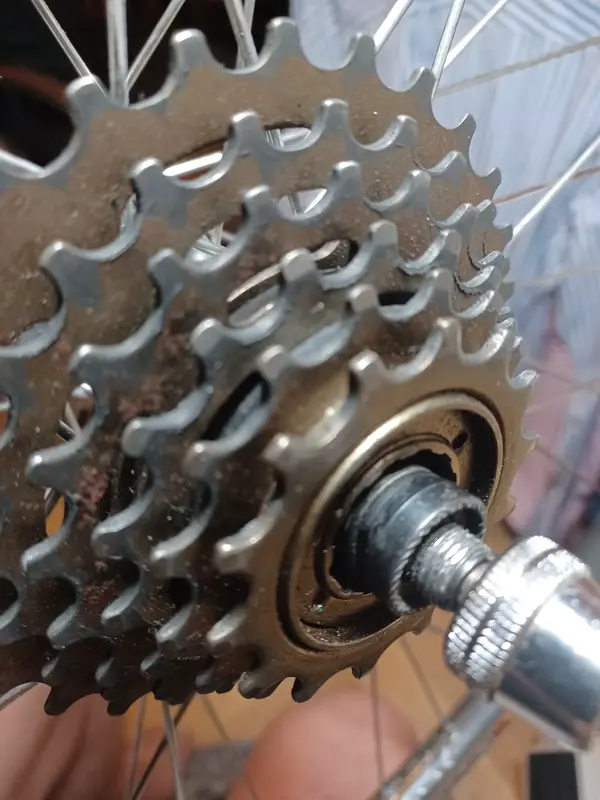

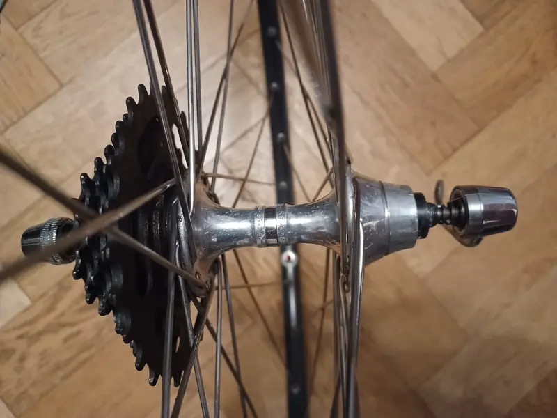

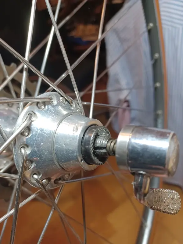

So job successfully completed, and I didn't need to reduce the axle length after removing/fitting slimmer spacers. Thanks for the advice given, I now have a very good set of 36 spoke Campagnolo C Record hubs on Ambrosio clincher rims (and hard to come by vs tubular) with an OLN of 126mm to run on my 6/7 speed setups.
