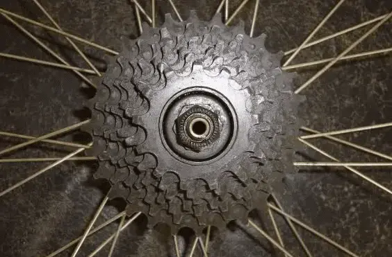

please be so kind and let me hijack this thread: i'm having the same problem. trying to undo the kassette of a suntour xcd hub that provides neither splines nor notches to start with. is the smallest cog a lock nut? it look's just like on this web picture. please help me with your experiences :wink:

That's a cassette. Having two chain whips will make easy work out of it. The smallest cog or the next one up will act as the lock ring.
