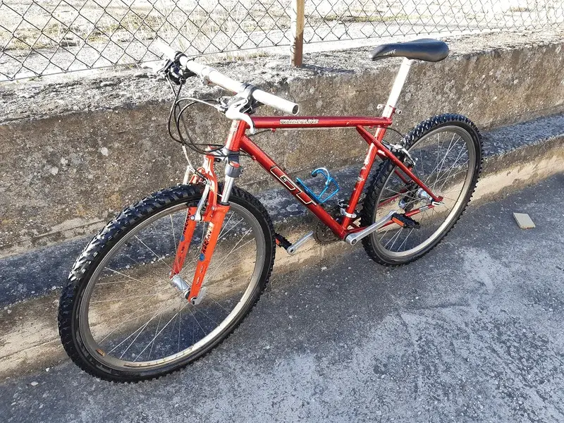

The fork (red ones) are probably way too long for the bike, but you could try them, you might like the way it rides.

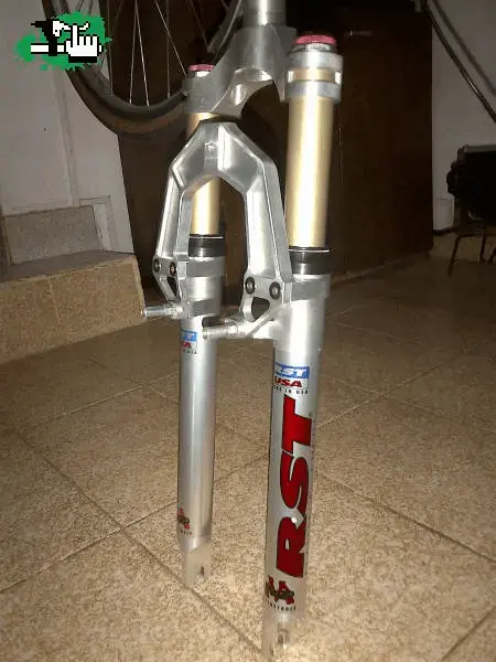

https://es.wallapop.com/item/horquilla-rst-460-798943840
RST Mozo USA, not easy to find one, but was nice finished:

Madjh. Is the RST460 the right length steerer tube for a threaded headset? The length of the headtube is 12 cm.
