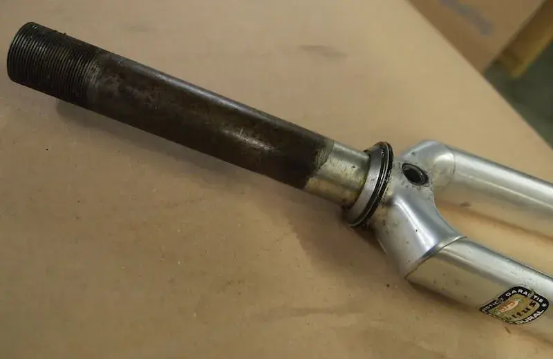

OK. In the interests of RB, I've had a look at the fork on my 979 (1987, 52cm, sky blue).
The steerer is definitely steel, not aluminium:
So some of the thermal ideas might be a good start after all. The bonding interface with the cast alu crown is at least 40mm long. The steel steerer runs down past the brake hole, so fit a front brake if you're worried about any twisting risk.
Also, it those methods don't work, it's easy to feel the alu/steel interface if you go for the longitudinal slicing method (as used on many a seat post).
Trashing a good stem will be considerably cheaper than sourcing all the other parts, and you'll be able to service the headset.

If you can see a bit of the steer tube will a magnet stick to it? Might confirm that it's steel and not alloy.
