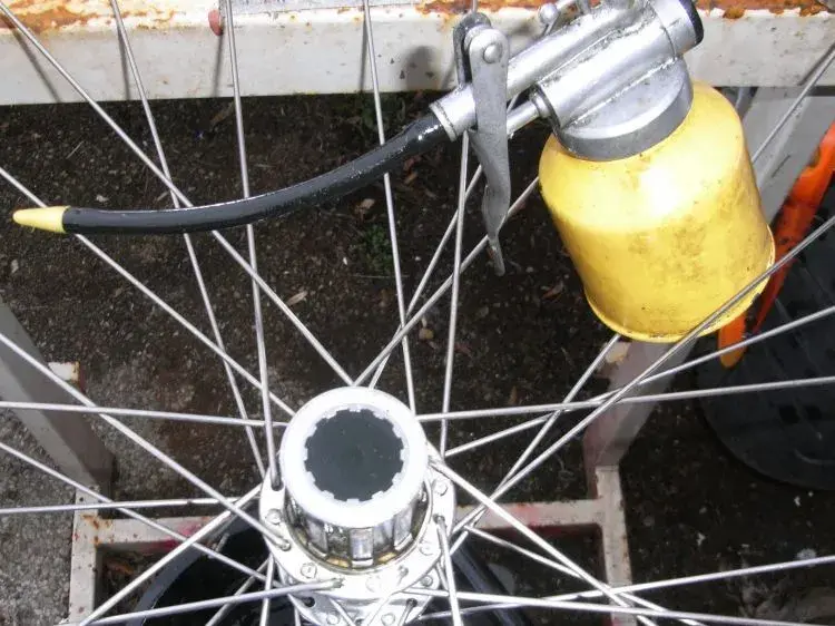

I drilled some holes in a bit of nylon and clamped it into the bearing, with a few Orings to seal it and
then pumped oil though it with a pump oil can.
I had a freehub that sounded like a load of bolts in a can, after pumping oil through it has been quiet for 3 or 4 years!

integerspin":2c3x9v8d said:
Taking them off doesn't make stripping them that much easier.
I guess I used an 11mm key long way in to get it apart.
Very interesting and I'd definitely want to oil mine, but I can't make out what's on the picture and you did. Maybe my hub is different. What I tried is spraying a lubricant from the other side with a straw nozzle
Can you elaborate?
The hub being oiled is an M732.
The only access to the freehub bearings is between the bearing race and the outer freehub body.
The nylon plug is sealed against the cassette nut and the bearing race.
Well it was intended to seal, it leaked quite a bit but I got enough pressure to force oil though the freehub, I had oil flowing out of the gap between freehub and the hub.
