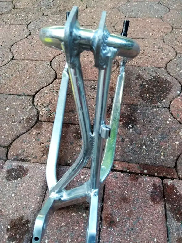

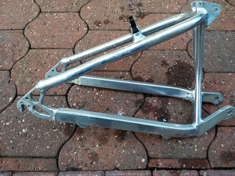

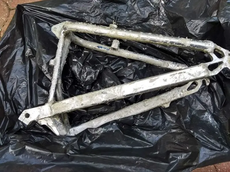

I will let you know tomorrow I've just applied some no nonsense paint striped to an alloy frame .I have found it depends mainly on what lacquer that is on there already. Cost £5.00 from screwfix with 1 p going to charity
:shock: Looks like that langlows has the COVID tax applied .. paid £25 for mine couple of years ago... done a couple of frames, doors in the house and still loads left... if all else fails, The langlows stuff WILL work ... i guarantee you of that :wink:
I uncovered the rear part of the frame that I put the stripper on this morning and all the old lacquer was soft .so gave it a pressure wash and all the old lacquer came straight off with no rubbing or scraping so then coated the front half with stripper and covered with black bin bag ready for tomorrow.
Here's photos of the back half.
