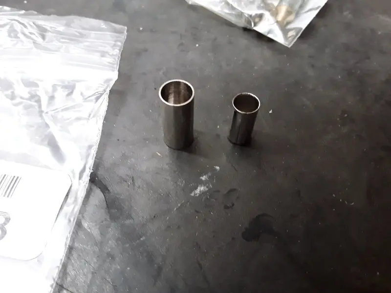

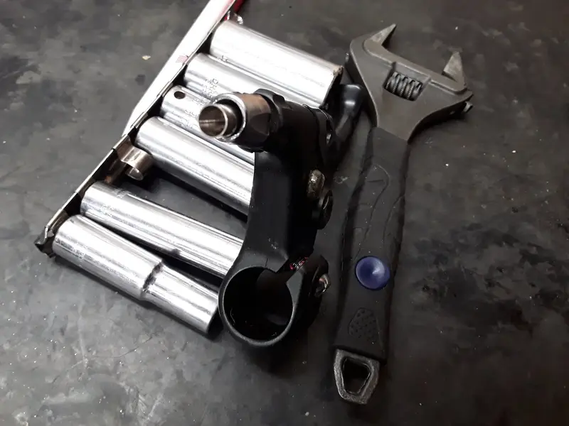

Here's a few shots from the cave.

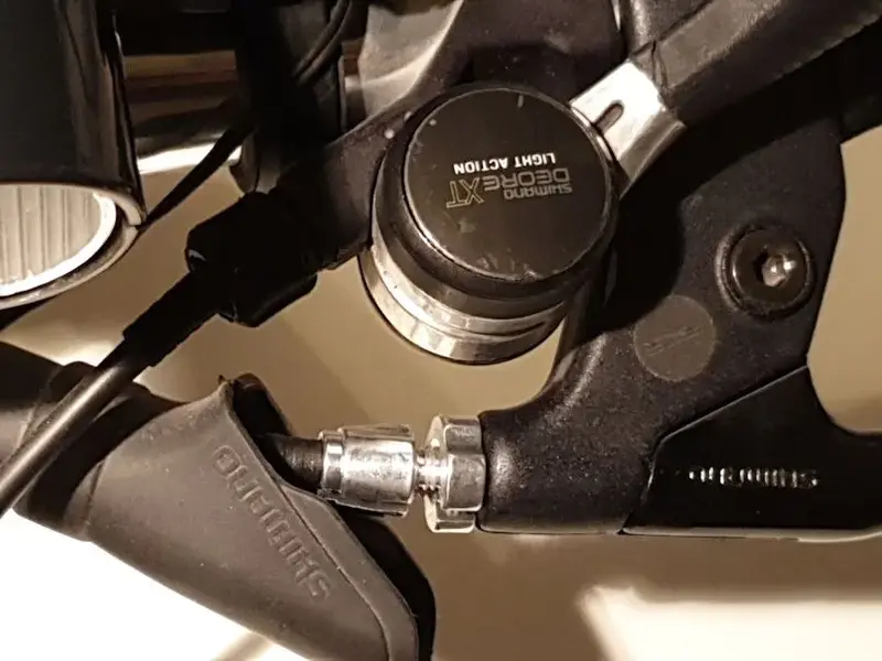

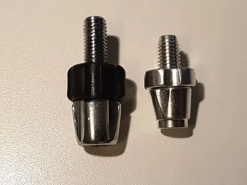

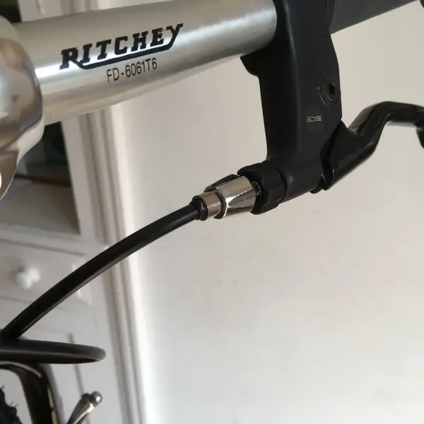

I simply went to my LBS and showed him the problem. He pulled open a drawer and located some barrel adjusters that had the correct thread for the XT levers and fit modern cables. Works like a treat, except for 2 small issues :
- the thread is only about 2/3 as long as that on the XT adjusters. Not really an issue for regular use, you just need to be a bit more precise when initially setting up the brakes. And if the cable were to stretch a lot, you'll need to get the wrenches out sooner than you would with the original adjuster.
- the size and diameter of the lockring and head are smaller than the original XT ones, resulting in the rubber dust boots being a lot more loose. I have yet to see them work their way off the adjuster on their own, so IMO it's not really an issue.
At some point I'll probably take the XT adjusters to a machine shop and ask them to make exact copies but with a smaller inner diameter. Can't be that expensive.
So the Venhill ferrules arrived and they work an absolute treat. The fit is a bit loose with standard Shimano ferrules, but very good with the slightly oversize ones which come with the TRP compressionless housing I’m using.
