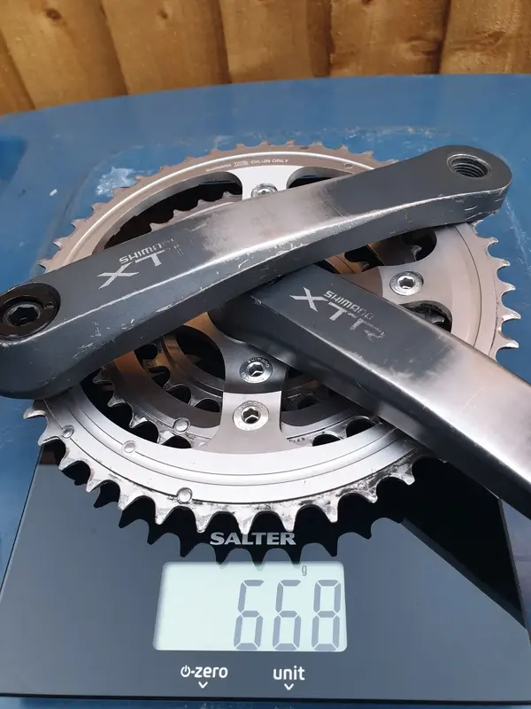

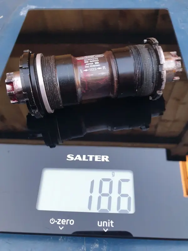

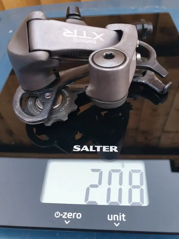

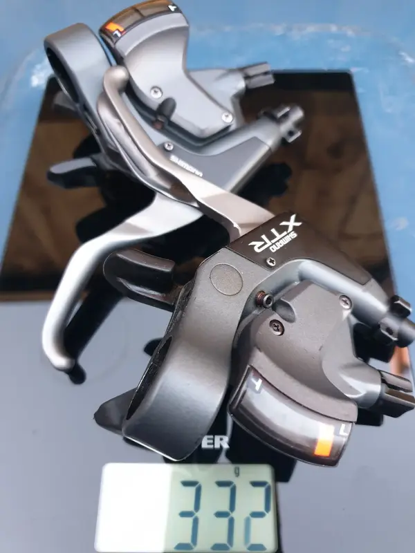

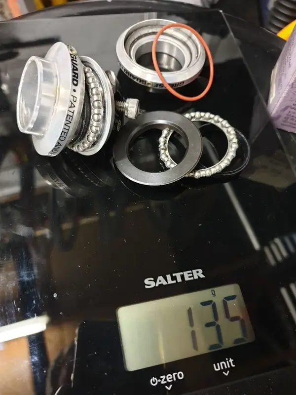

Bit more work on it today, installed a lovely WTB headset that I've had in storage a few months waiting for the right build, also some locally sourced M950 parts that i've stripped and cleaned out, actually never stripped down a rear mech to the extent of this one, even to point of prying seals off the jockey bearings, clearing out the crud and repacking with grease, these are all tip-top bits now :)

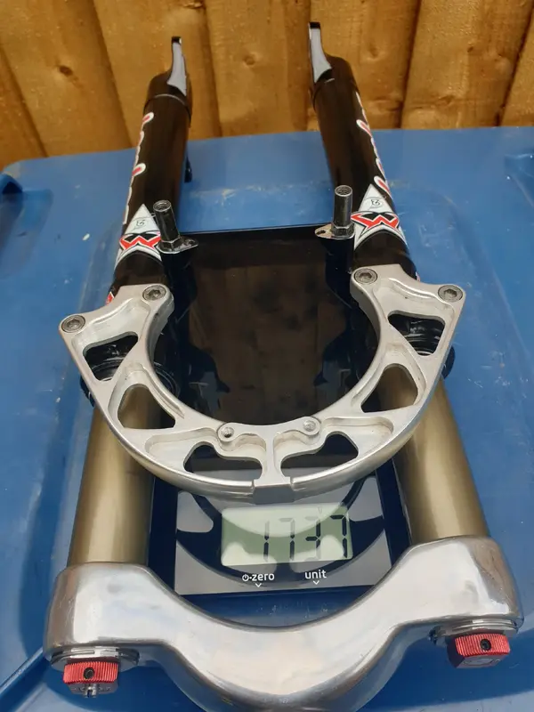

Pressed in the headset today and managed to obtain this Bomber Z2 BAM fork up from a good bloke/fellow member on here... as you can see from the pics it's hardly seen any use, despite this, as I always do, I completely stripped it out...
Never smelt shock oil like it in my life, absolutely STUNK for some reason... anyhow that's been disposed of and replaced with fresh uprated 10wt @ oil height of 40mm to suit my portly frame. When it arrived it came with shock boots... not sure if these were factory fit or aftermarket as all the other bombers I've ever got hold of came without boots, these will really only ever see light duties so i'm thinking of keeping them off for now, might also swapout all the bolts for gold Ti affairs (crown and bridge) but depends how silly I start going with this build...
