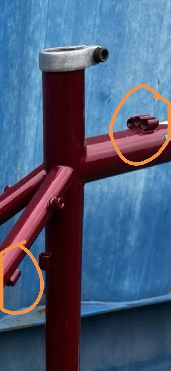

It also has cage bosses on the underside of the downtube...
Maybe a custom option or perhaps added later.
