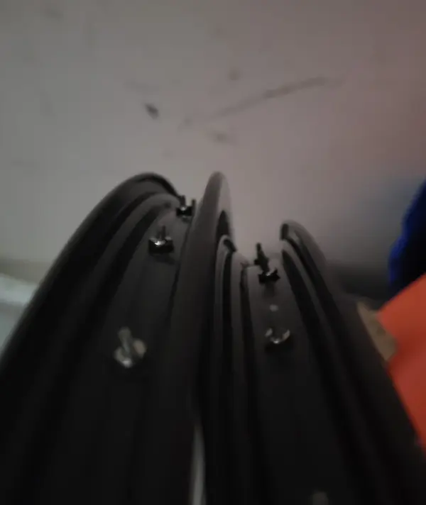

I'm gonna cut my losses and order shorter spokes(265 mm), i tryed several ways and spokes always stick out.. on both wheels and using difrent assembly patterns 😪😪
I don't know how they managed to put them long spokes at the factory mind..

I'm gonna cut my losses and order shorter spokes now as its impossible to put 270s in them wheels, at least i cant.. they stick out about 5mm

I follow up the 3x pattern,i disassembled the whells a few times and tried again and again even followed youtube videos and they always stick out about 5mm on BOTH wheels and EVERY spoke
Did you try 4X, I missed the picture above, but it does collaborate with my best guess of reading the picture.
4X isn't common as they often hit the spoke head. But it would take of 5mm from each spoke easily.
