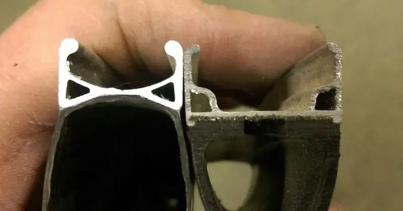

If the rim is riveted I'd be tempted to un-rivet it and see if it is a standard rim. How many rivets? You might just be able to get a standard replacement and pop it on (though keeping it straight when doing this would be a trick I think).
I'd not consider repairing the damage as I doubt it would be safe myself.

if the rim section is anything like the ones on Zipp or Spin/X-core wheels.
Both are lightweight proprietary extrusions, rather than anything off the shelf.
If it's scrap anyway (and you don't want to hang it on the wall) it might be worth drilling out the rivets and seeing what's going on, like iShaw suggested. You just might be lucky.

Ahh rollocks, seems the general consensus is that it would be a load of work with limited chance of success. Back on the bay they go then!!!!
