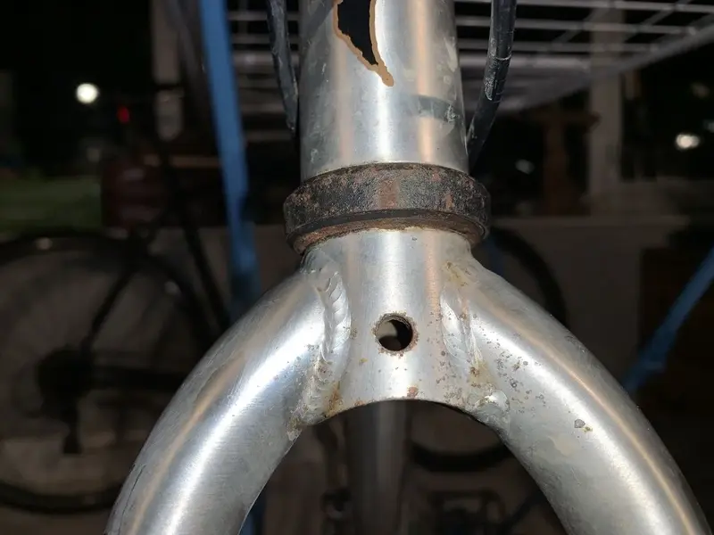

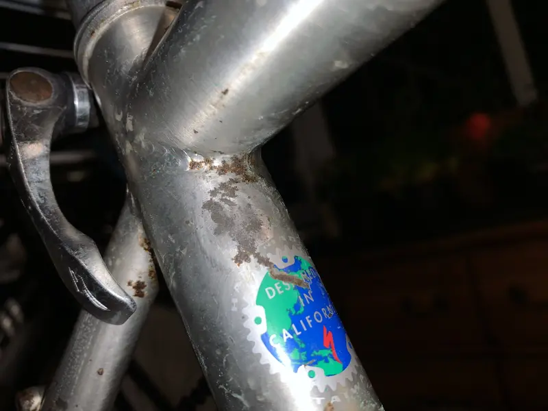

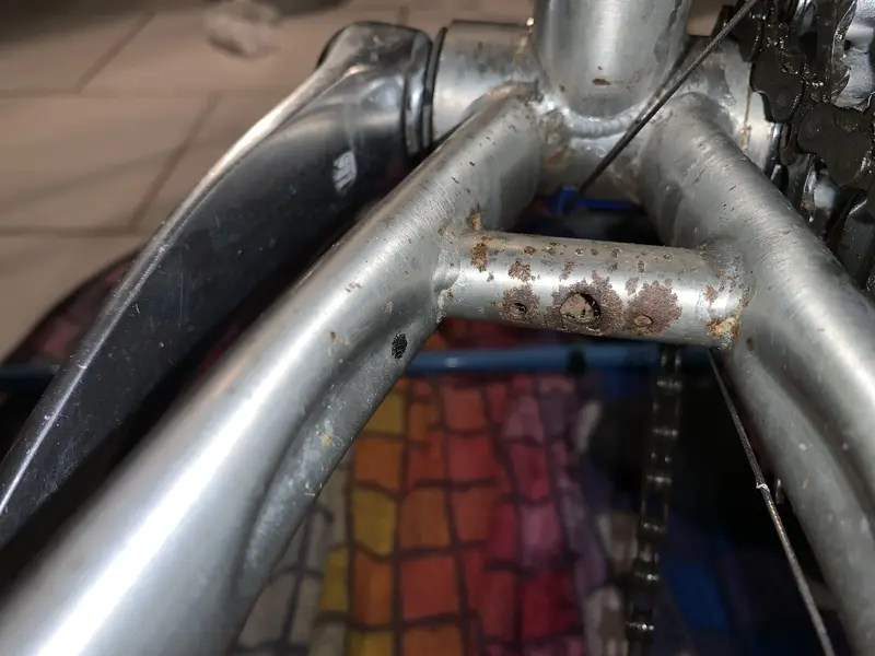

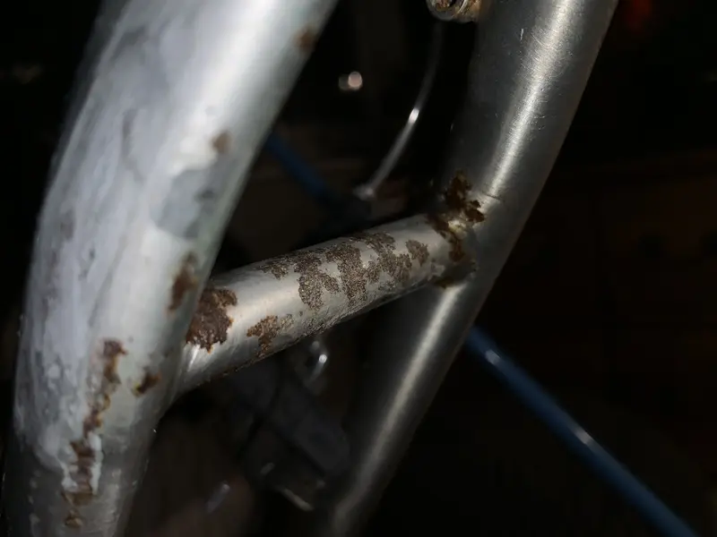

That’s some really useful stuff thanks. I’m beginning to think that a respray may be needed. You can see where I have managed to scrub some of the rust off but other sections are too deep to get off. I’ll attach more photos.
